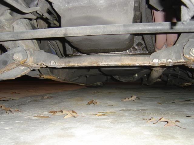

here's somthing you might want to consider,
if your not going to "Z" the frame then your not going to lay actual frame in the front because the front crossmember will keep your truck from doing that (unless it has been previously ....ahem..."filed down".
so if you do drop it level with the 2X4 then the rockers won't lay very well in the front.
the stock leif (or lief)spring hangers also lay below the the frame rail as doe's the main crossmember in the center of the truck.
so i think it's a good idea to drop it on the ground instead with a fresh front crossmember.
this is a problem i ran into.
my truck was bodydropped with a pre-FILED front crossmember.
the problem is whenever i replace it my rockers no longer lay as hard.

don't miss understand me here guys,
what i was trying to say is...
let's see ...how should i put this....
in order to get the front of the frame trully flat on the ground ,that front crossmember has to be "filed" down almost halfway down into the nuts and bolts (which is not at all good unless your just going to lay your truck from that point on).
that's why i was suggesting to body drop it with a fresh crossmember first on a flat surface (of course cut it how you actually want it to lay first then drop it to the ground).
so at this point you will be laying/dragging rocker but you wont be trully dragging frame (cuz you'll be dragging crossmember).
but...if and when you decide to "Z" that frame then you'll be crushing that rocker hard.
of course the better way would have been to 'Z" first then b/d.
anyhow meybe i should have just answered "yes" the body is a little past the frame.
please correct me if i'm wrong guys.
