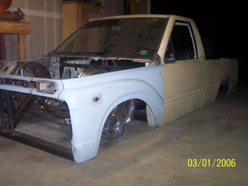

On page 7 of this thread aresome pics.
Says since the photos they have cut it till the bottom door hinge and it now sits at 36 inches. The 22s are stick way above the bed rails though. Kinda confused on that.

that truck is 36 inches, has 7 1/2 out of the door and 3 out of the roof. just like i said, you have to section the body and top to get there! the new truck is being sectioned, but in the center of the doors, so it will have a more fatory look than just chopped off. the front end of that truck would definatly not have been my choice, just my opinion though. oh, and 22's are just to damn big for something like that! i know it is hard for some guys to picture getting to the 36" mark, but i assure you, it is possible!!! later, brian

it has to be, the stock Isuzu door is 46.25" from bottom to top. i just measured a 94 door i had in the garage. i had a 85 pup longbed i did a 2" body drop and 3" chop top....laid the winshield back for the chop. that roof line was at 44 or so inches from the ground and this was back about 10 years or so. truck is long gone. ill have to find pictures of it and scan them in

do the math!! take 4 inches off the roof, take another 4 out of the bottom(what is actually channeling) and after 7 inches of body drop and laying back the doors to meet the roof, it is actually correct. i done all the work myself, so i know what was done, and what it was when finished. also, like i stated in the past, it was built just to mess with peoples mind not be a show truck. i am redoing all of it after 10 years of being m.i.a. so when it is done, i will let everyone see exactly that it is not a f***in typo! hell i will even send you a free tape measure signed by the master himself!!! ME
