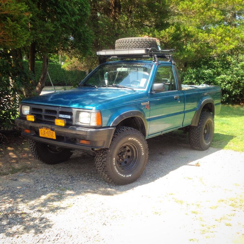

3 inch lift
Re index torsion bar
Procomp extended shocks (for 3 inch lift)
2 inch block and rite ride airbags on rear
