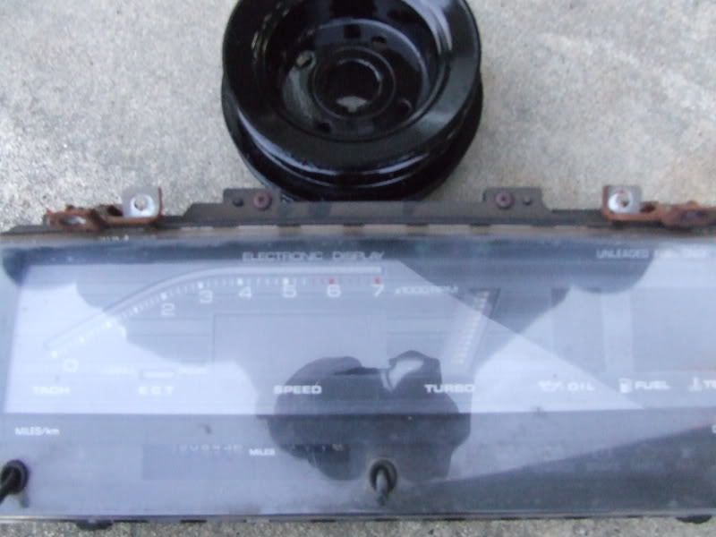

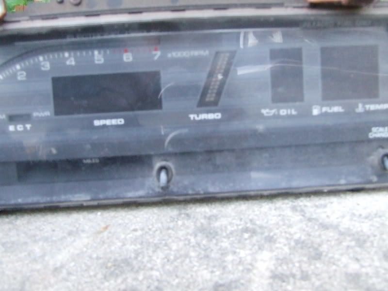

oldsklminitrk
Ok Zombie is right aslong asyou dont have the digital dash.....the digital dashes take alot of work and you have to have the sending units....Ive got one floating around I was gonna use but with all the work it takes...Im gonna pass....I have done the swap and it all baiscaly works.
vegasyota94's avatar
vegasyota94
you dont have one around there
oldsklminitrk
Damn I just got called out......
oldsklminitrk
OWWWWW look there it is....sitting next to a harmonic balancer....
