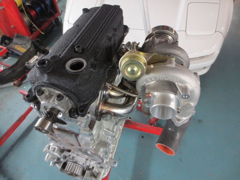

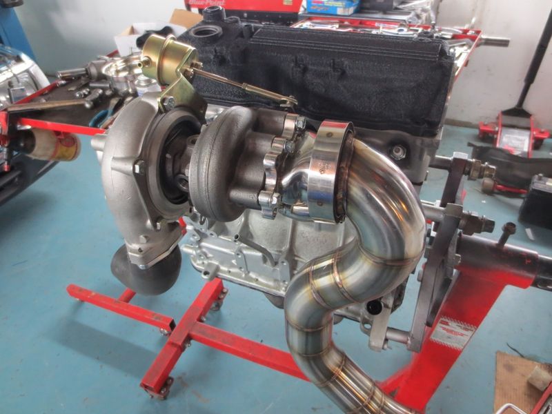

I will try to upload pics.
The old IHI turbos kept dying because the bearings died.
anguswilly
Rebuilding these old turbo is just not worth it, you can buy a way better turbo for less than a rebuild.

It's really not worth it, I was burning one every month or so. They are like over 23+ years old now - just as easy to build one using a modern turbo - maybe easier.

anguswilly
OK, need to resize pics obviously...

What about using the Probe mani with t3/t4 turbo?

anguswilly
Yes, but you'll need to make an adapter, the IHI flange is a small square.
