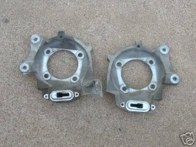

Is anyone running rear disc brakes on their dime? I'm looking for some pics of a factory rear disc brake setup from the late models. don't care where you get the pics just need a few!

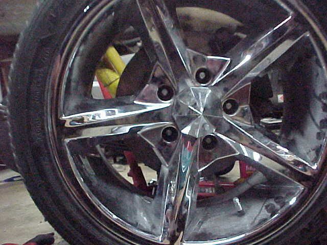

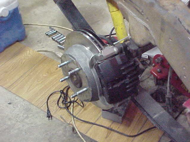

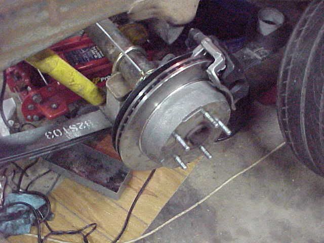

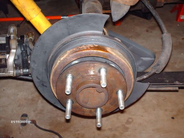

I did a rear disc swap to my factory axle on my 97 sonoma
tofnlows10
whats are those off of?...looks sweet!
nvious kreationz's avatar
nvious kreationz
98 up blazer with 2wd rotors

yeah, mine came off the same thing. You're a fuckin' pimp Nvious. Could you do me a big favor if it's not too much trouble? Can you get a couple good shots of the back side of the assembly?

i might be able to grab some my bed is back on now what are you needing I did it all myself so I can answer some questions

whats the caplier attached to??.
nvious kreationz
You have to pull the axles from the tubes after you take off all of the drum hardware so all you have is an open axle tube and a square flange and these bolt to the flange after you get the spacing correct and the dust shield also the caiper bolts to these and the e-brake cable clips in aswell
maz89
yeah, I know how it goes on, I got the parts like 4 years ago and it's all been sittin' in a 5gallon bucket ever since that day lol, just wanted some pics to make sure I got every thing before I got started. now, what were you saying about spacing at the flange?
