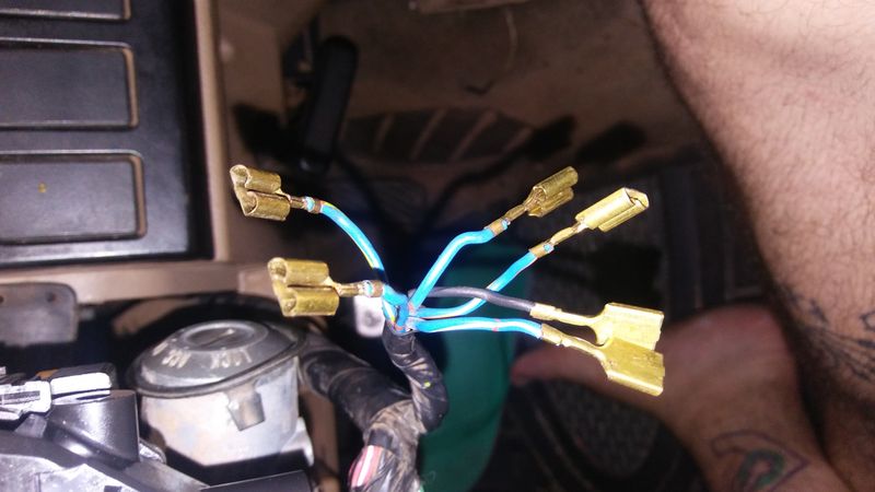

The plastic clip holding the wiper control wires broke on my 92 b2200. Can someone send me a picture of both sides of the plug so I can correctly conext them to the plug till I can find another female clip. JC Whitney and Summit does not carry those little plastic female clips for these plugs and even the auto parts stores here in town don't carry them. Stupid.
