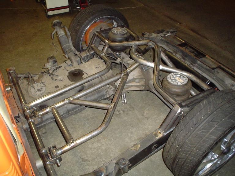

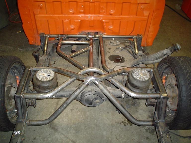

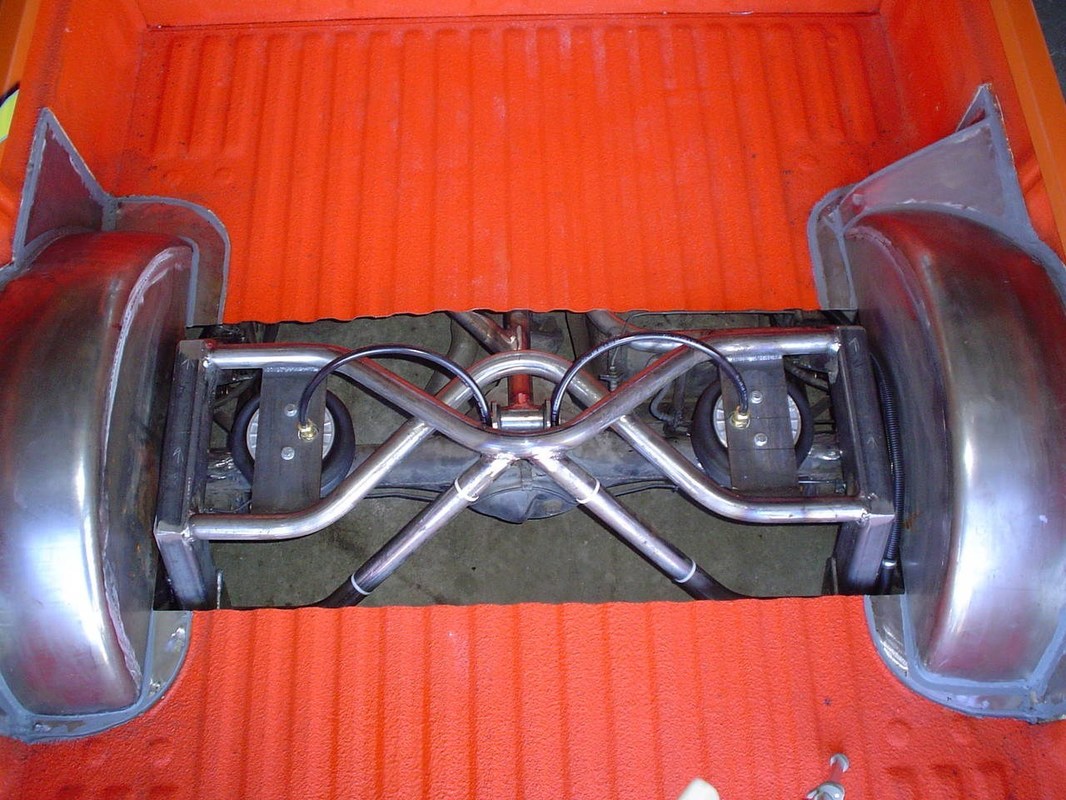

Look at my Profile, The Bags are on the out side of the frame next to pivot point, I have had this set up for 8 years and have had no problems, it lays frame. The bed is off and you can see a descent picture of it. Without the shocks you get 14 " of lift, I am now limited to the shock travel. I did not change the perch locations either. Take a look, it may help you.

Look cool, but I'll bet your axle moves back a good three inches when lifted, lets see a picture! Dont forget one of the pinion angle at +14 inches!
I get ~14 inches of lift too, my pinion angle change is +/- 1 degree and the axle moves forward/aft 0 inches.
You body dropped 3 1/2 inches to lay rocker?

Just to set it straight, This suspension has been done for over 8 Years. I know we have come a long way in that time with different set ups, hell even bags, I remember 1/4" line on push button Air ride Gauges with 1/8" dumps. SLOW. But, I have driven 48,000 miles with this set up and have not had any problems, Yes at 14" the pinion angle sucks, But I would not drive it that high. Yes I body dropped it 3 1/2", and the rockers do get dragged, we did chop the rocker down a bit by pie splicing them and welding it all back up, should of went more YES, but that was back then!!!!! The Jest of this is to say This truck has been around for awhile, I've owned it 10 years and it was lowered the week I bought it. Bagged a year and a half after that, body dropped 4 years after that. I know there's better ways now, but don't hate something that was built before your time! I have had several projects and you learn along the way. But I own this and will die owning this and it will be built again and probably rebuilt after that! I will build something else better. Nuff said!
