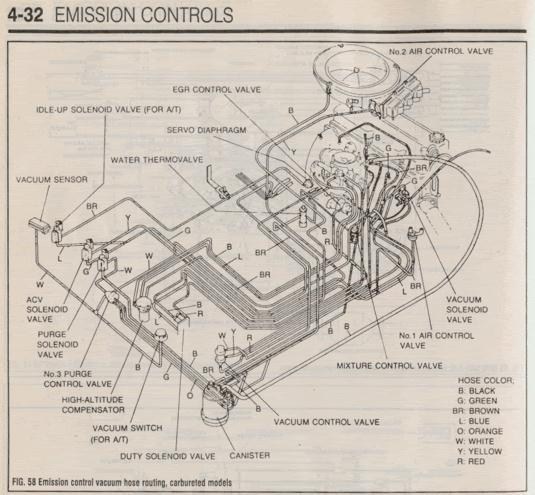

I'm thinking it could be your vaccum lines I got a pic of where all the hoses are supposed to go hope this helps

I agree with vacuum hoses. And with the automatic statement, but if I remember correctly yours is a 5 spd.

definitely makes me think vacuum leak, stopping fast means you are hard on the brakes and the booster is using engine vacuum.
