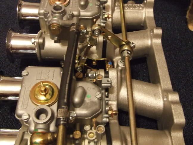

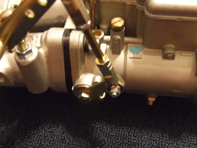

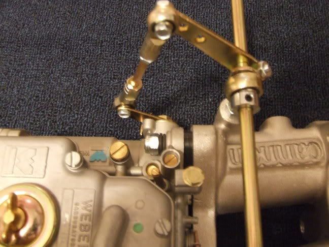

oldsklminitrk
Ok here is a few pics of the linkage.....these pics will help cause the directions suck ass.....

Got a pic of how the throttle cable hooks up? Man I can't wait to get my manifold so I can put my carbs on Nice What fuel pump are you going to use cause that one goes to far in front of the stock one

Nah I didnt get them from LC I shopped around I only spent about 900 and that was for all new parts......tommorw Ill install it so ill show you the cable linkage and as for the fuel pump Im running the stock one...I bought the weber regulator...these thing only work with about 4 to 6 psi so the factory pump is well plenty for now.....lol for now!

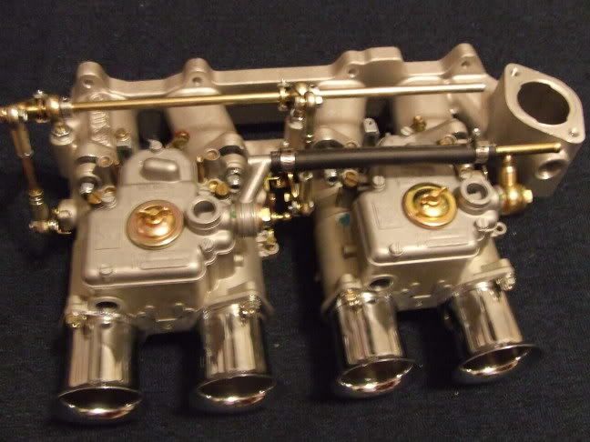

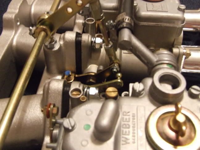

oldsklminitrk

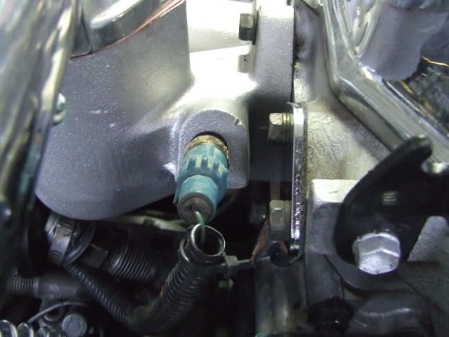

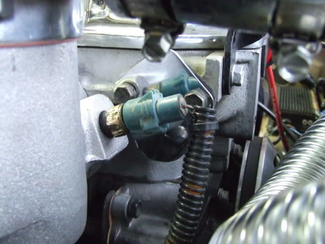

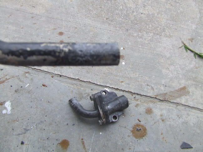

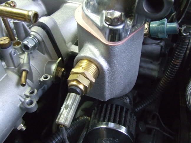

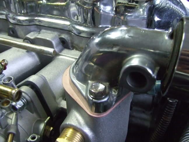

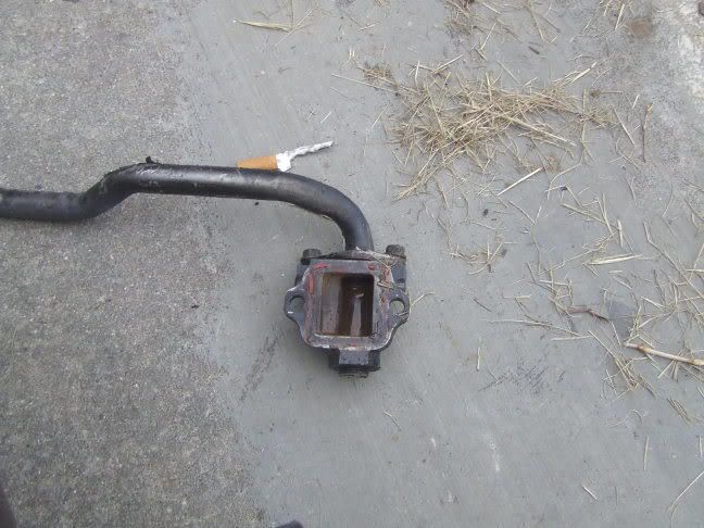

Ok here is a update on the install you have to do some fabbing but nothing to hard.The water pipe that goes into the intake you have to bypass it.These few pics should help ya....also dont try and run a factory fuel pump.....doesnt work unless you dont wanna run gauges.
