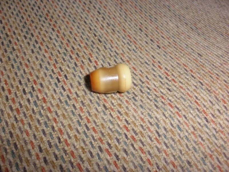

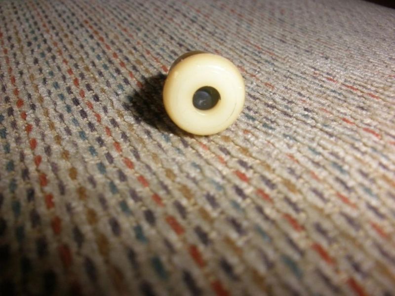

In case you wondered what the one-way valve looks like...

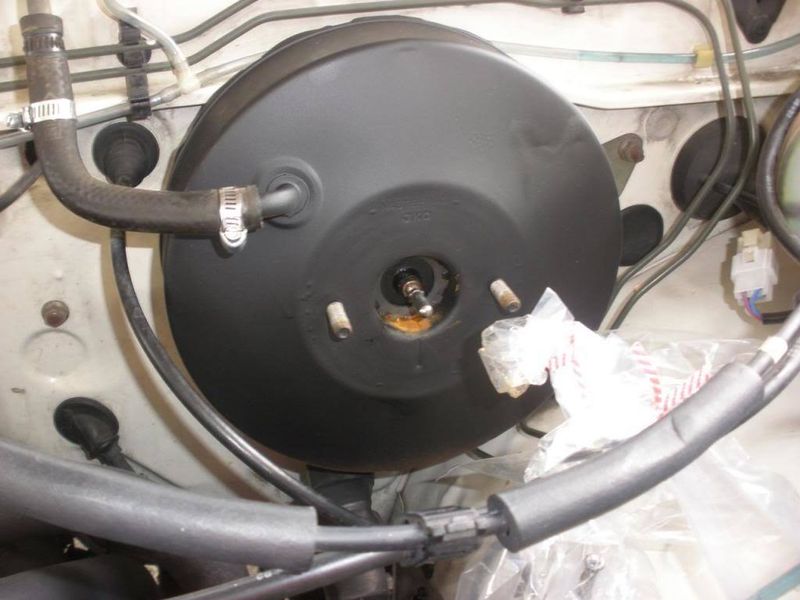

Well, I just checked and the line from intake into the hardline, and out of hardline into booster is ordinary heater hose line
I can blow through it both directions with no resistance, light shines right thru it from end to end
Clues tell me that piece is not in there
could this be part of my problem?

Yep, sounds like your problem... at least with the brakes not holding boost. You can get a new brake hose with the valve or get one form a junk yard... I have the valve or a hose with a valve available if you can't find one.

I think that will be the same hose/valve part. Yes, you shouldn't be able to see through, or blow through except one way (and that's also tough, and not too good-tasting).

Also, when installing a new master cylinder you MUST make sure your brake booster is set properly. Here is a sample of how to do that...
Blocking the pedal from going to the floor will only drastically increase your bleeding time as the reduced pedal travel will not allow you to get a "full" push. The only way to damage the master is if the booster push rod is adjusted incorrectly.
It sounds to me you have either multiple issues or you have not performed all the diagnostics needed to determine the real problem.
I would start by getting a new one way valve on the booster then bleed the brakes appropriately then check for leaks etc.
