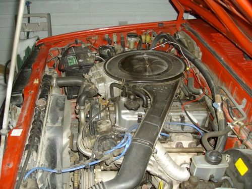

OK, now I'm committing to the Kia engine.
Will take a few months to get the parts, so this thread is going to die for a while.
But first some before pics.
://farm4.static.flickr.com/3299/3346084578_6125c14e5a.jpg?v=0
Front, Left viewed from right
://farm4.static.flickr.com/3405/3345250383_b614ac3602.jpg?v=0
Right Viewed from Left, Workshop
://farm4.static.flickr.com/3323/3346085084_17a30cb297.jpg?v=0
Lift (folded away for storage), Tools
