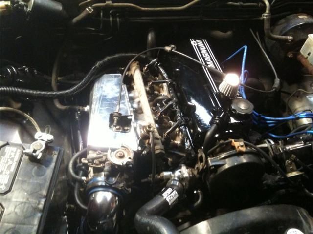

This exactly what I would like to build!
I know it's a custom built plenum, but I have no idea what the dimensions are to build it. Any way you do or can figure it out? I know that the factory B22 EFI manifold will work great also, but I really like the looks of this. Do you happen to know what they all used to make this? I read HappyTealMazda's build thread on how to but I'm unsure on what manifold he originally started with? Is it a MX-6/Probe or a Factory B22 or a 626? Everything after that (injectors, TB, fuel rail, ect ect) I can figure out.......I think
If you could help me out that would be great man. Thanks.

Angus do you think you could help me build this if I can get the parts needed and ship them to you pay you for your fab work and for the shipping back??? I would really like to do this build for EFI but don't have the access to the tools needed plus I'm not a quality aluminum welder haha. I got all the measurements from orangemazda2000.
Let me know man either way. Thanks a lot bro.
Chance
here it is in action...
" target="_blank

I don't know exactly how this manifold was made, I'm sure that they took a gasket for the lower/upper and made that out of aluminum. 12v head will flow a good bit better, I know that with Xulf's different 12v head running a Weber 38 he noticed that his acceleration was a bit faster and he had power up through 5500 RPMs with the same carburetor/ignition/transmission/exhaust setup.
