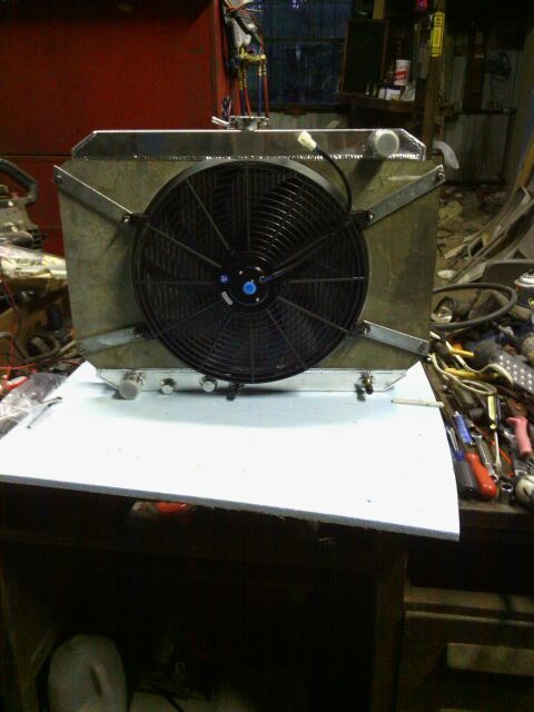

naya337
Our radiators measure 21 x14, could I put dual 10s or would that be overkill?
8
89bluedemon
That might be overkill. 16" 2500 cfm fan.

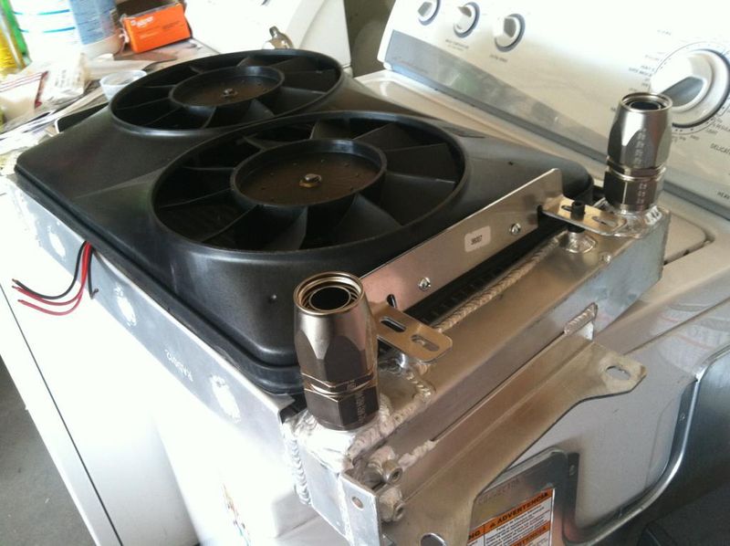

dvsdev
I have a 12" fan mounted in front of my radiator, I upgraded to a 2" thick aluminium radiator and ditched the manual fan altogether, cut the top hose in half and fitted a temperature probe adapter in there, then a electric fan controller takes care of the rest.
The fan switches on if I'm stuck in traffic or sitting at the lights for a few minutes, don't forget, fans only do their job while the vehicle is stationary, when driving forwards the manual far will slow right down to almost stopping, that's why they have a clutch.
Oh, and with my fan mounted to the front I still had enough room to fit a oil cooler next to it.
mymmeryloss's avatar
mymmeryloss
Cusser's avatar
Cusser
Wow !!! Bet that keeps that washin' machine running cool !!!
