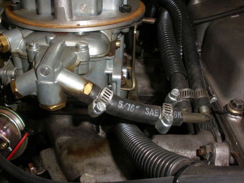

It sounds like the return line to the fuel tank? Here on my automatic you can see the return line. .
On my return line is a one way valve to ensure the fuel flows up only one hose to the carb.
Or it's a vent line for the 5 speed. I believe if you hook it to a vacuum source it will draw fuel and or fumes into the manifold and possibly mess up your mixture.

All of mine is after the FPR.
Tank (with internal FP) to FPR
FPR to splitter
Splitter to Carb
Splitter to one way valve
One way valve to tank (with internal FP)

I put a FPR on my recent weber install, I checked to see what the pressure from the factory mechanical pump was, mine was just over 6psi, weber recommends 2-2.5psi so I would run a reg regardless of being factory mechanical or electric fuel pump.
I also plugged the carb return line, option I did was pull the fitting out from carb, cut off barb, fill the whole thing with solder, refit fitting and re-sealed around the fitting with a fuel safe thread lock solution.
Depending on your setup, if you have a good inline filter you could just split the fuel inlet hose and fit to both carb fittings, looking at them they both hook-up before the needle anyway so it should be all good... Should be.

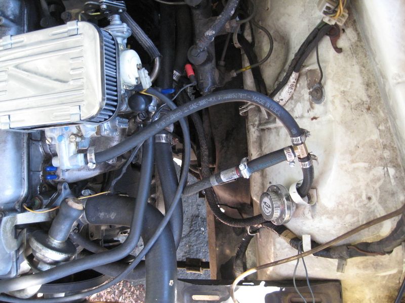

burtandurny101
Ok..... got tubing and a splitter today. could not for the life of me locate a fuel rated check valve: but a miracle happened and little metal nipal already stock on the return line turned out to be one! Great sucess.
Just making double sure, i was supposed to hook the check valve so fuel may only run down the return line?
So the fuel line goes to the FPR, FPR to splitter, splitter to (fuel filter then too) carb, splitter to check valve (set so that fuel will only flow into the return line).
I have notice that the tube going to the check valve from the splitter bulges a bit.... what gives??
Also! what is the most premium Fuel Pressure to run? my reg is adjustable to the .5 PSI (1-7 or something).
Thanks a bunch! I'll snap a photo right fast and throw em' on here.
burtandurny101
I have since added the fuel filter on the line headed to the carb, but this is my set-up.
