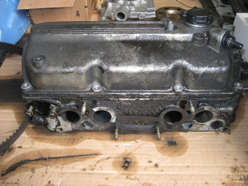

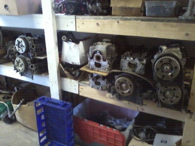

Here is my new head:

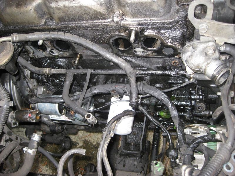

Old Head:

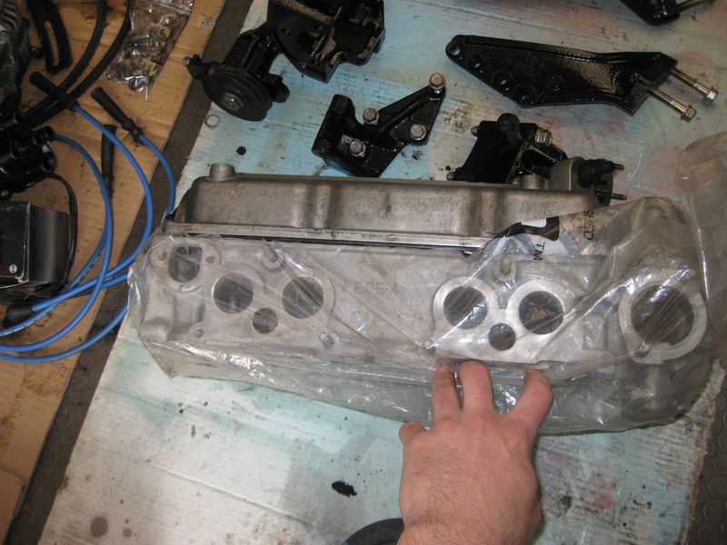

and my intake:
It appears i'm missing the egr port. HRm........I'm not sure what to do about this...Anybody?

hmm. weird, just looked at my b2000 head in my back seat and it has the hole that yours is missing. I would think you could just block it off somhow being people block theirs off by removing egr valve and making a block off plate, I would just go to a junk yard and find one tho cause theres no telling what kind of leaks you could end up with later down the road if u just block it off. unless your a good welder and know for sure that the rest would line up and work properly, I never heard of that scenario.

IDK if I were you, I would not even try to install that new head, as it does not look right at all. I would take it back, and get the right one for it.
If you try to install that one, you might get stuck with it, as it is now a "used" one.
mazdafvr
i think hes right the dizzy gear hole is on the intake side, didn't even see that, I don't think that's the right head man. the hole for the dizzy to slide in should be on the same side as the exhaust manifold. id suggest sending it back and getting the right one.

I bought it off of a Dude on Craigslist. Probably won't be able to find him again. I thought the hole was on the wrong side initially, but that's the thermostat housing.
The head came complete with a front cover. Everything lines up correct, valve cover fits, it's just the weird missing port. I did find one other person complaining of the same issue, but nobody seems to know what the heck is going on.
Maybe it's some freak year or something.
