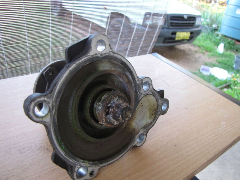

You mean that the vanes on the original water pump were corroded away in 16 years? Wow. We need to see that, please post a picture. Of the water pump. Or yourself.

missvix
Not corroded so much, but the guy was running it on straight town water and our water has a high level of calcium in it. So she's seized up due to calcium deposits in it

missvix
And here you go Cusser Just for you lol
missvix
That's what a mechanic mate said too. It's shocking
