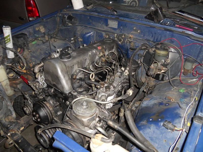

You could do what I did with my Toyota 4x4, 3.0L Turbo Diesel

Oh wow, very nice daily driver or? built? just curious why go with diesel or you do lots of haulin? Just curious why went with a diesel lol, nothing against it. but i say you get some good mpg with it and some hellacious torque, but eh i wanna stay gas never been a diesel fan to much motor noise for my liking. But I actually was looking on craigslist, if i can get ahold of the guy he has a ka24de sitting i his car that was wrecked in a t bone accident, ( he was T-boned but ok) and downer is auto tranny, plus side, 1996, odometer reads 78K miles nice low mileage, also only 250$ for the motor with no ecu or wiring harness ( thinking stand alone?) or would i still need the ecu for this? also another plus, i have a solid running truck, i can take my time building the motor slowly, seeing what will/won't work for me an my preference, and give me time get driveshaft and transmission built. ( tranny just modified ) and i'd be set i'd be able to get it within the next month or so gonna offer him a little more cash to hold it for me, usualy works if not no biggie but hey sells easier when you offer to pull it as well.

Its a daily driver. I went with the diesel because it was a massive upgrade in power and fuel economy.....and just because I love diesels It gets about 34mpg hwy unloaded and when I loaded almost 2000lbs in the bed and drove 1,400 miles at 75mph I still averaged 31mpg. I also take it offroading very frequently and the torque is amazing for that. I even turned the boost down from stock to 8psi for better fuel economy and it is still surprisingly fast. If the roads are damp at all I can break the tires loose in a straight line at 70mph lol.
I cant wait to see how your swap turns out. That sounds like a good deal for the engine and tranny although running an automatic is more difficult since its electronically controlled so you would need the stock ecu and wiring harness. What performance upgrades are you going to do to? Turbo?
