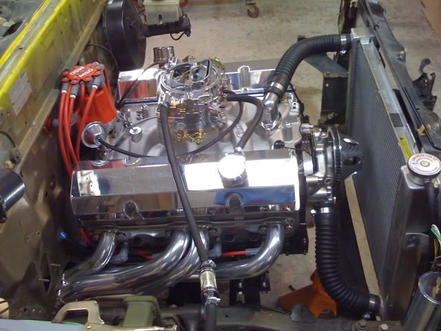

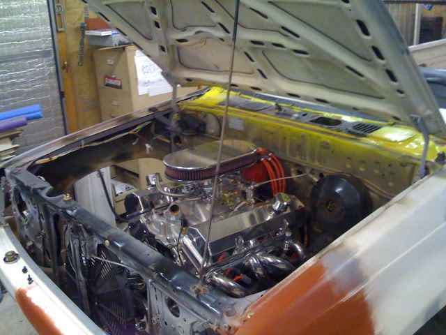

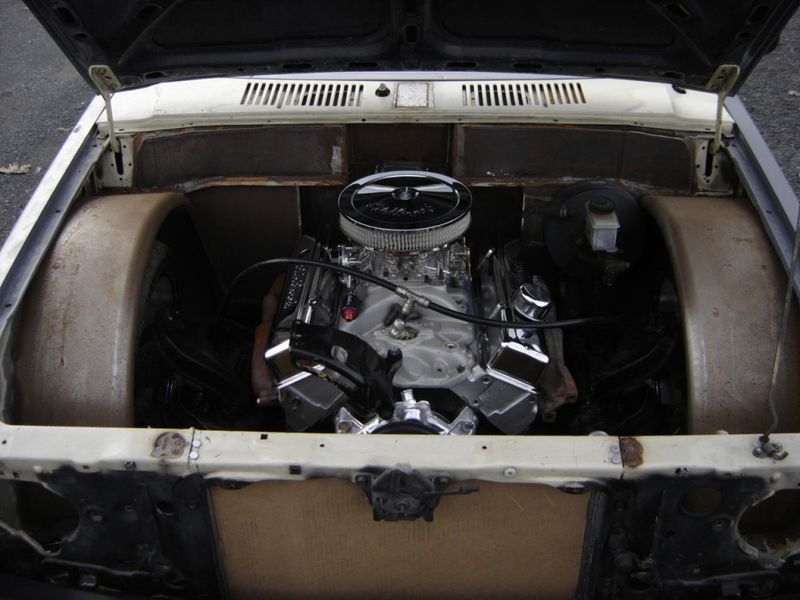

i have a 350 in mine and would more than happy to help you figure out any problems you run into.

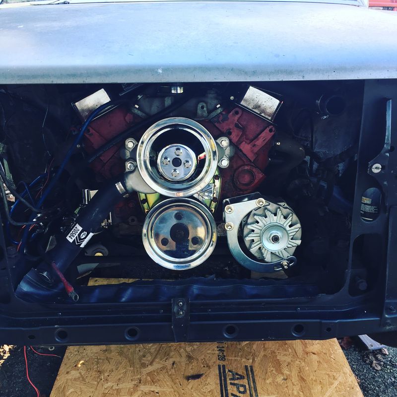

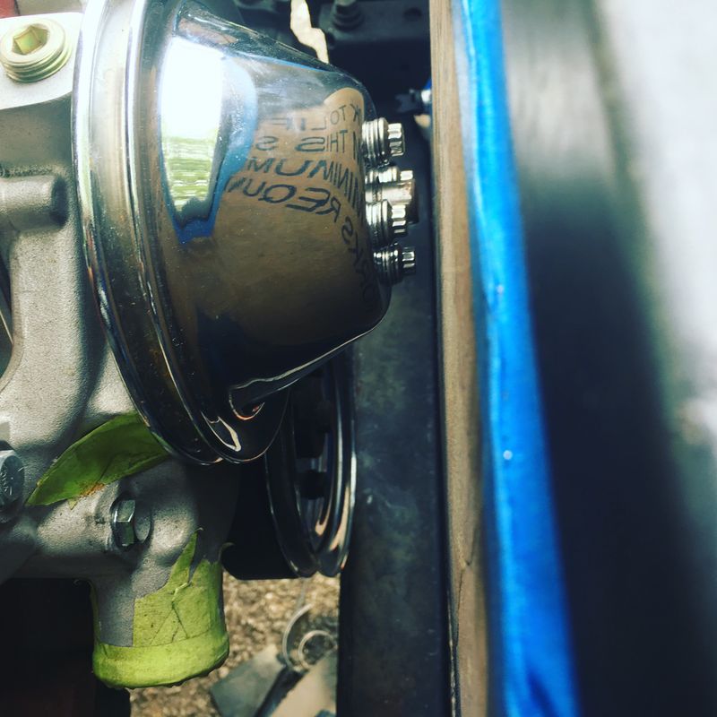

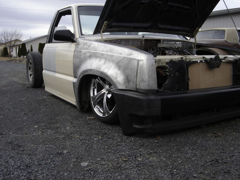

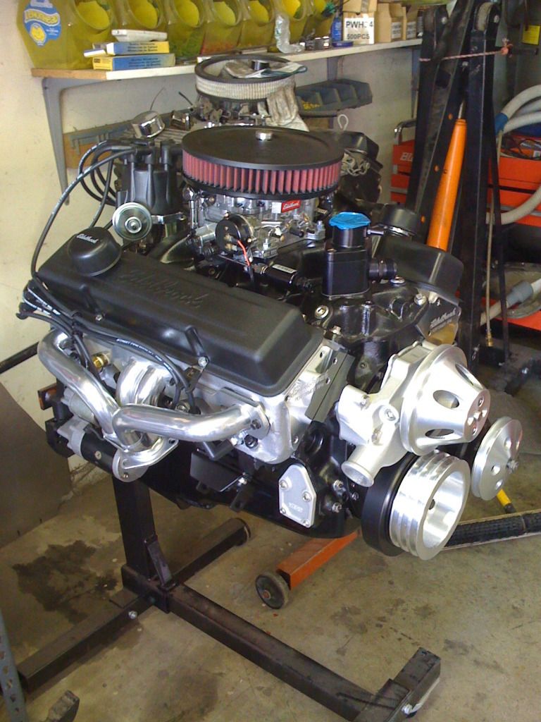

I too did a SBC swap with a turbo 350 trans in my old mazda. I was going to just run my Toyota axle. Your gonna want to run short water pump front accessories for added clearance, that what I did and lookd like 007bob did also. Mine fit under a stock bubble hood while being BD'ed to the pinch. Heres a few pics of it while being mocked up and a pic of the engine that I was going to use on the stand.

haha okay thanks! well the motor I'm getting. looks far from as clean as yours. but it. has potential what should I do to clean the block and intake manifand extirior, I'm probably gonna replace the rest with new. should I gut my entire engine bay of the stock stuff to start?
dragginmazda86 (dave)
As long as in runs good, you can always clean the engine and paint it to look nice again. I wouldnt say gut the whole bay, just the engine, trans, all clutch parts, and most of the harness on the passenger side wheel well.
