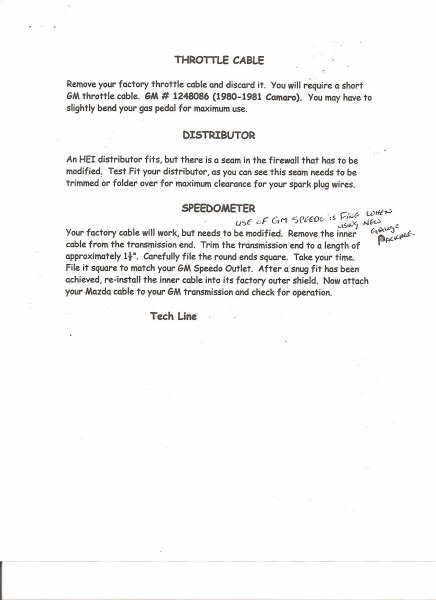

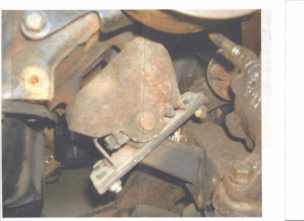

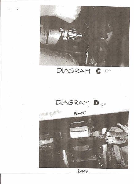

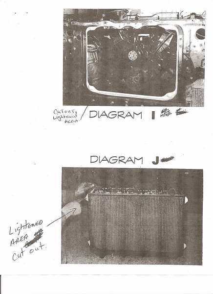

V8 swap instructions
elbine69's avatar
elbine69

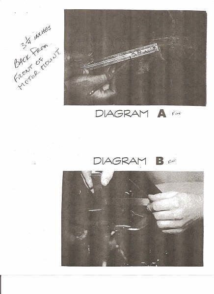

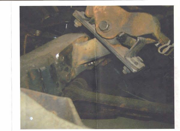

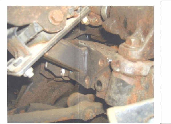

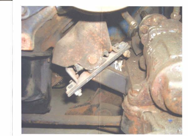

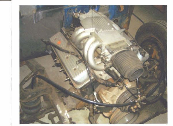

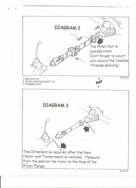

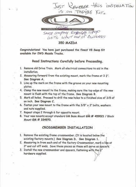

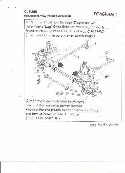

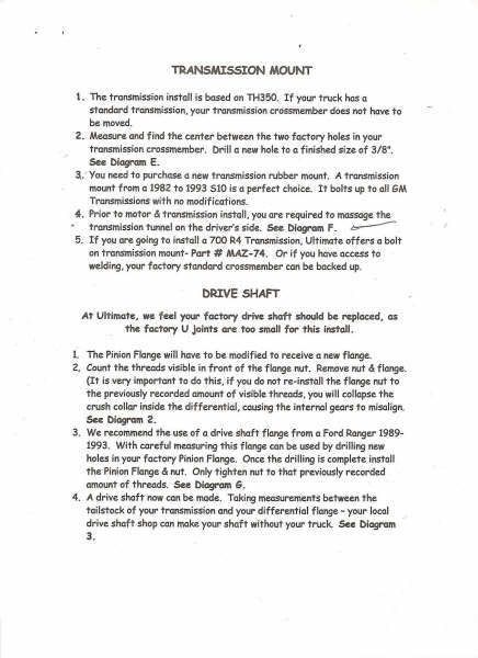

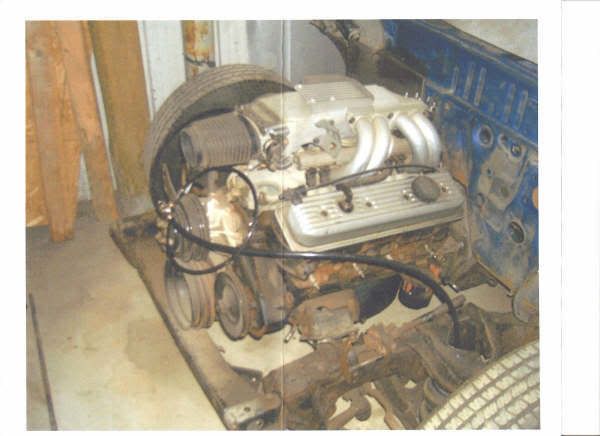

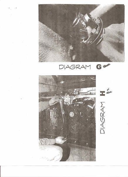

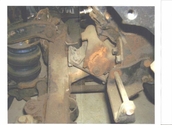

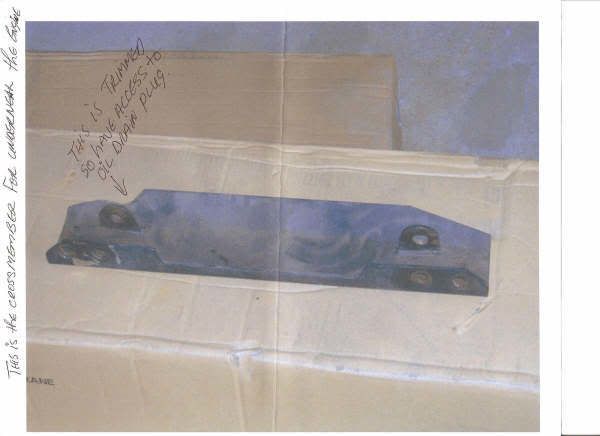

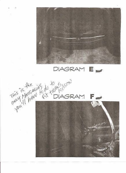

From ultimate customs

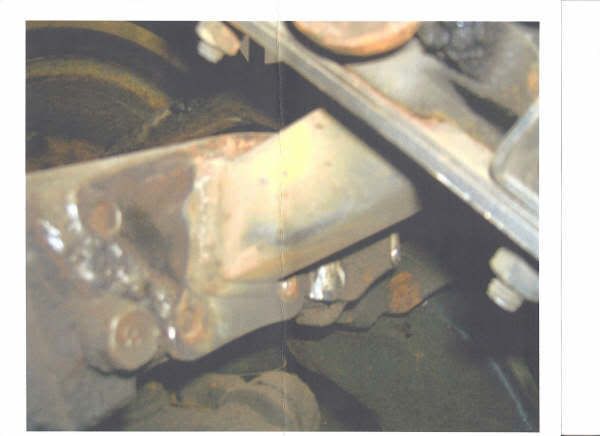

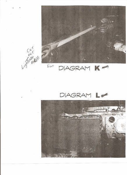

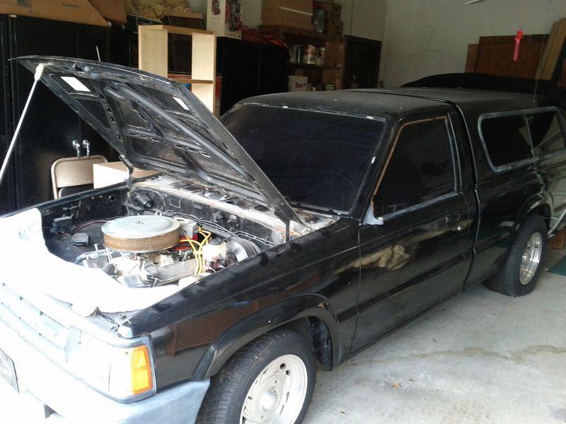

ya just remember that all those pics are of my truck guys.

BRAVO... excelletn write up.
V
v8mazda4ever
ya loyd did have some great swap kits out there and I must say one of the best kits to slam a v-8 in our trucks.

hmm... this makes me think... a few questions for you..
Do you have to alter the stock hood??? I know you would to do a bodydrop but as long as its not obnoxious... i wouldn't mind
Would this be easier than doin a 302 swap??
If you put a carb'd 350 in, you jus need the engine and transmissin right??? And driveshaft obviously. But no computer or any wiring BS like that....
I'm sure i'll think of more questions.... I'm really becoming resentful toward my 2.6L
elbine69's avatar
elbine69
Itll fit with a stock hood, but if your bd a cowl might be needed. Probably same difficulty in doing a 350 or a 302, depending on how you mount the 350 you might need to clearance the firewall for the distributor. And yeah no computer. I hear you about being resentful of the 2.6L, I got so pissed at mine I yanked it out and sent it to the scrapyard
