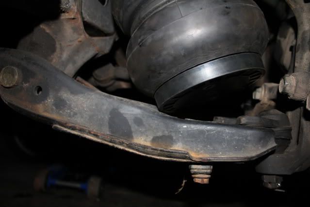

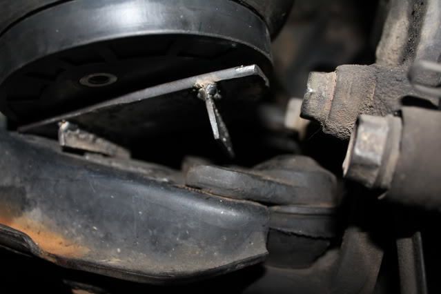

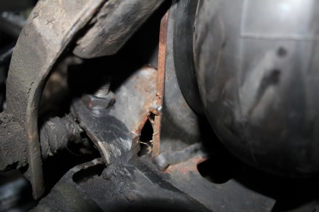

Okay welllll...I tried making brackets to make the bags sit straight like a wedge with a bolt hole....But twas no good. I didn't count on the hub, tires, and rims weighing down the lower control arms and throwing off all the measurements I made today..please keep in mind that the "bracket" I made was just get measurements and be a base of what I was going to make..Not what I planned on welding in....
Now if any knows of a simpler, cheaper, safer way of doing this please let me know...
pics of the uppers and lowers
This is the bag Straight up and down (like it should be)

Compress the bag and bring the lower control arm up like it is at full drop. Center the bag without rubbing on anything and go from there.

Compressing the bag on it's self is an easy and sure way to keep it straight. The bag is ok if it is curved out when lifted, but you want it to sit straight while compressed.

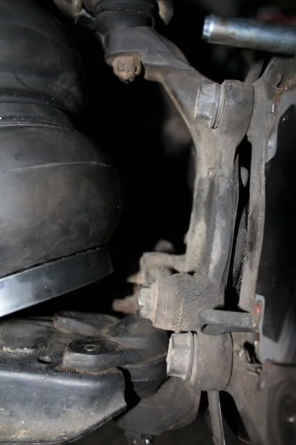

iculookn42's avatar
iculookn42
In this picture i have about 10 psi in the bag. I hope this helps.
majordrop's avatar
majordrop
okay that helps a ton...i've been getting told that if it's angled at lift or ride height then thats bad...
but that makes a lot more sense. because the way it is now fully compressed it almost sits in it self...which im sure is no good with it slightly getting pinched..

If it's angled its not going to hurt it at all, if anything help it.
Bagged s10s run this all day long, my mazdas front end setup is almost the same.
