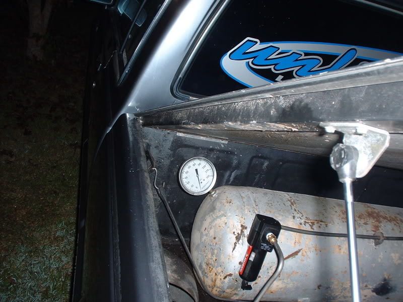

This guage...stayed here 90% of the time.
Was on this tank.

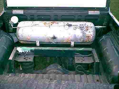

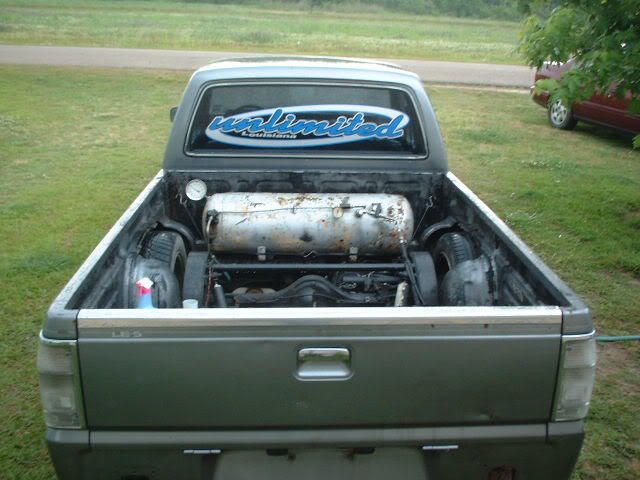

Or, an overall pic.
