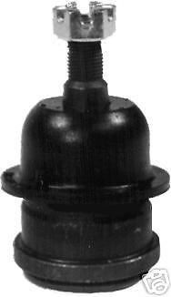

here it is, the lower one. I can get a better picture if i need to. it has 4 bolts.
joshbrennan
those lower balljoints come with the drop spindles and are simply an s10 lower balljoint pressed into the 3/8" plate with the 4 bolt pattern.
you can buy them from aim, but they are pricey:
or you can just go out and buy some s10 lower balljoints, press the old ones out of the 3/8" plate and press in the new ones.
slammin91's avatar
slammin91
cool!! that looks just like it. thanks a bunch i probably would have never found the right one. never would have guessed it to be a s-10 one.

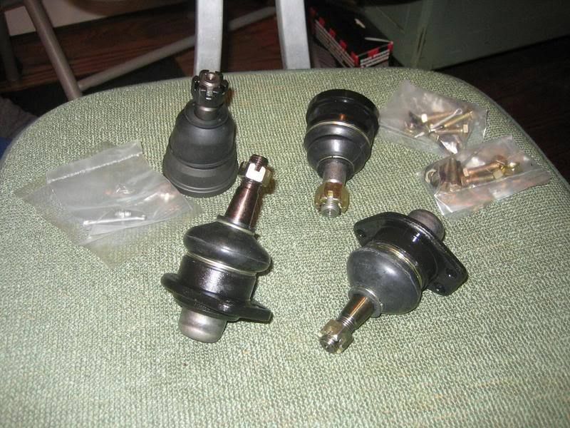

bodied b2600zx (josh)
Heres what ya need, these are the uppers and lowers for any 2wd s10 like 87-03 or whatever, I got mine! obviously......
mr.bbs
awesome, i didnt know i needed S10 uippers, thanks for the heads up pal...
You dont HAVE to have em, but the more mazda stuuf you take off and replace w/ s10 (ball joints) the less binding you'll have
