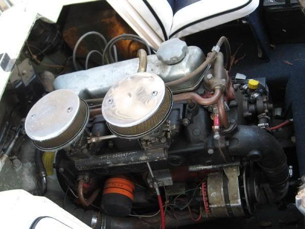

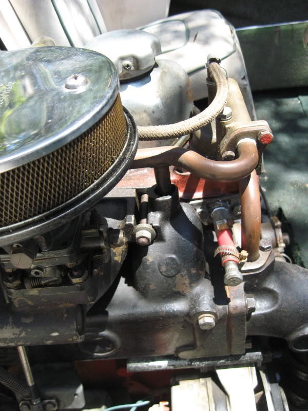

slammedyota91's avatar
slammedyota91
Heres the engine, The yellow cap is where I have installed a fitting for a water hose to hook up to for out of water operation..
elbine69's avatar
elbine69
Im sure you have, but I have to ask. Have you looked to see if there is any water in the oil?
