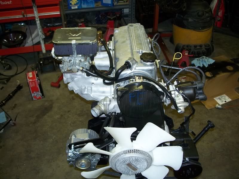

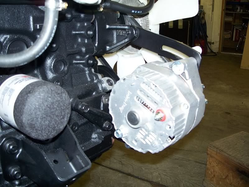

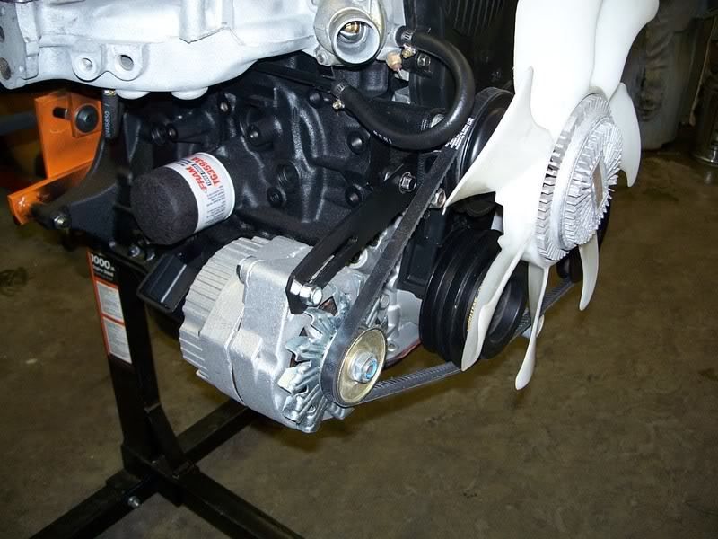

dragginmazda86 (dave)
Heres a few pics of the GM 1 wire on my 2.2.
90-b22dawg [andrew]'s avatar
90-b22dawg [andrew]
ok so the blue will be for positive straight to battery? and the red is??? also what model number is that alt?
