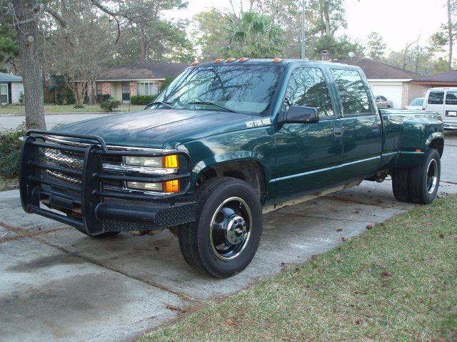

The '98 crew had those steel Frito 19.5's, 4.10's, 4L80E, Sneeker wrecker unit, and a bazillion miles - oh, and that freakin' Ranch Hand heavy SOB -

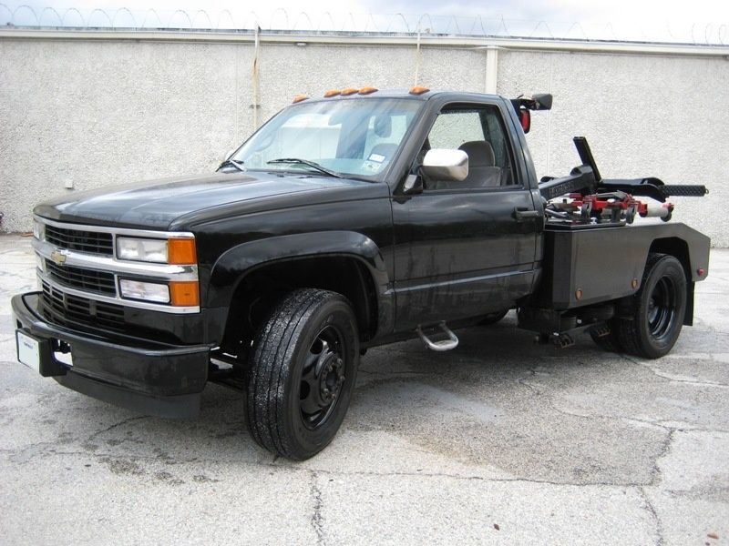

The '94 3500HD with the '96 7.4 transplant, Dynamic self-loader wrecker unit, steel factory 19.5's of course, 4.63's and a 5 speed -

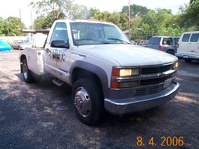

Then the old '98 3500HD company truck, 7.4, 4L80E, Vulcan Intruder wrecker, 200K miles of "not my truck" on it, sumbitch burned a quart of oil every 100 miles - this truck also scales around 10K lbs
