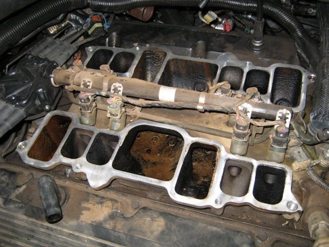

its a 99 dually with the 454..just started running horrible..sometimes can drive 100 miles,,sometimes 1..then it starts missing and running ruff. and u can smell gas..so i hooked it to my snap on mt2500 and it says driver bank running rich...ive changed..distibutor cap..button..pick up coil..plugs..wires..ignition control module..map sensor..coil pack..has brand new fuel pump and filter..and #1 injector..after changing injector..ran stronger than ever for about 5 miles..then backfired and started doing it again..i bought the truck in tx in december and drove it to ky..but when i read live from my scanner it will randomly say misfire..cylinder 1 then maybe 3 and 5 then maybe 8..just jumps around..then sometimes no misfires..idles fine..sounds great..even at idle u can floor it and no misses..also checked compression and its fine..and no fluids mixed as far as a head gasket or anything..and doesnt run hot...any suggestions would b great..its the schoolnu dually..im gonna post pics if i can figure out how

more pics
jessejames7575
pics
