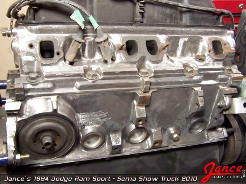

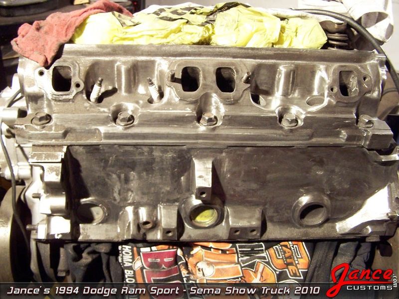

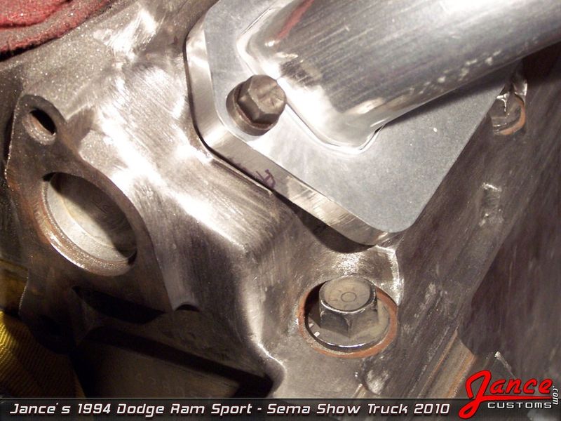

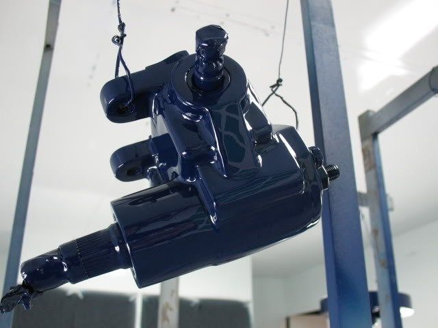

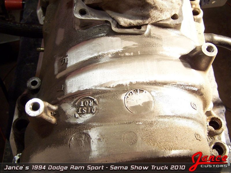

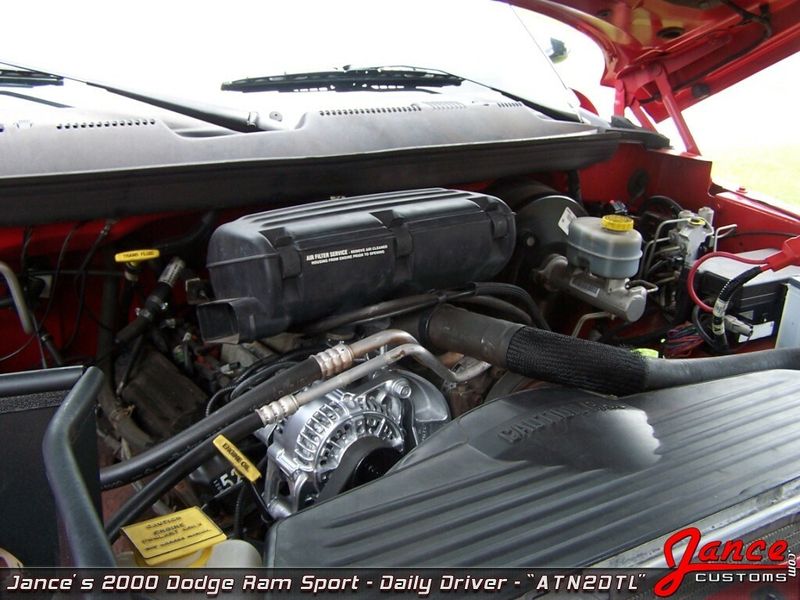

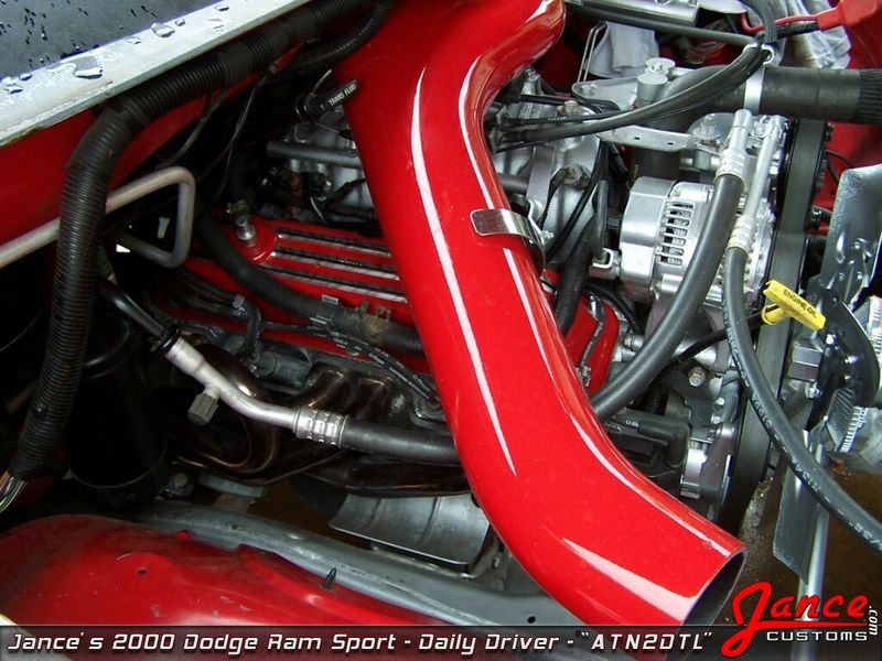

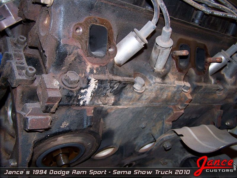

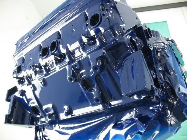

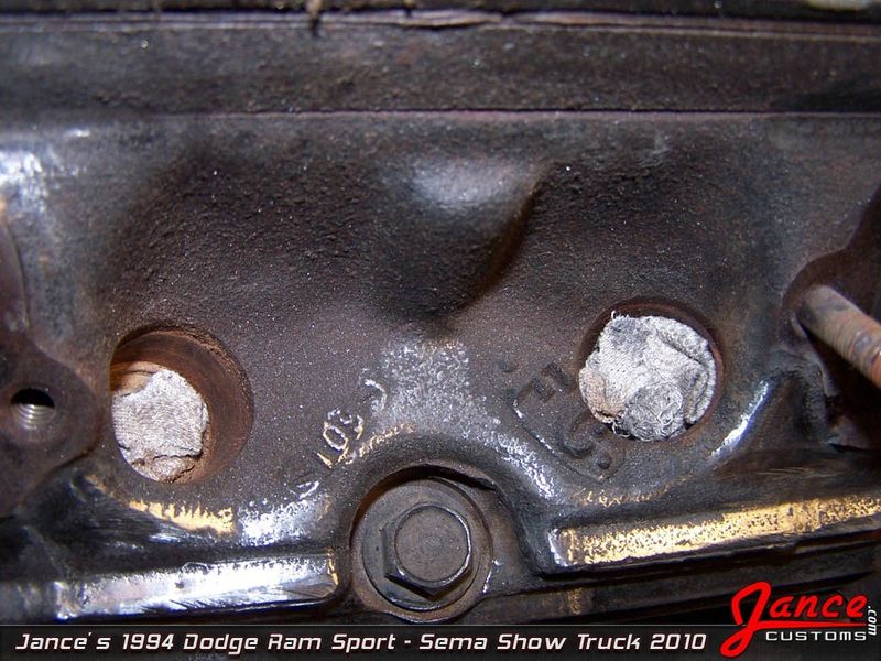

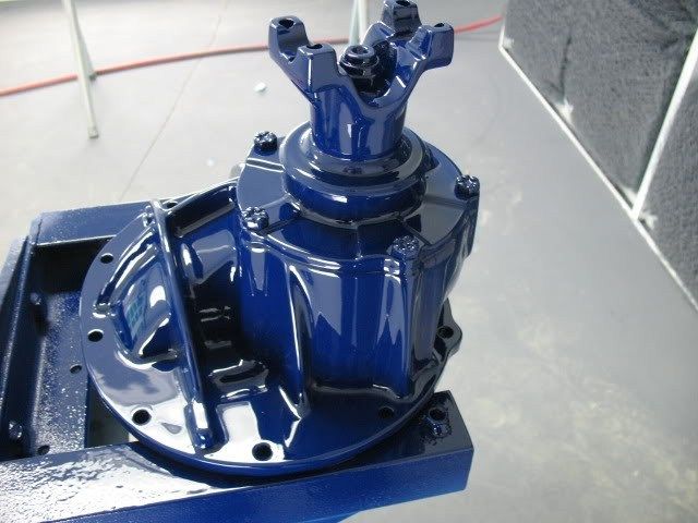

If you're wanting to get the small tight details, I'll sell you a ziplock bag full of dremel sanding bands for $20 shipped.
Sorry for the big pics!
Before
After
Before
After
I used other tools as well, but I used the sanding bands for the all the detail work. It just takes a lot of time...
