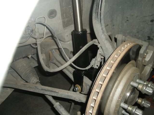

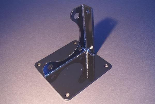

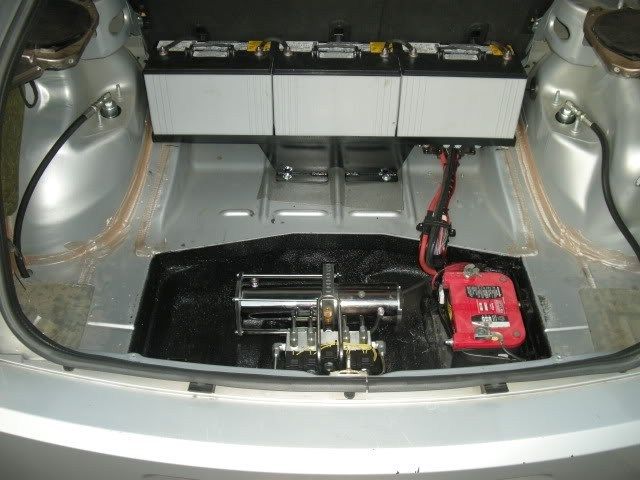

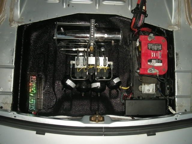

Well here goes another one. This was dropped off yesterday. I plumbed up the pumps and dumps last night then got to work this morning. So far I have the battery rack made, painted and installed. The batteries were supplied by the owner, I guess they are batteries for a freightliner (he works for them). They are a little larger than normal and have all the correct ratings, so they should work perfect. The solenoids are also mounted to the battery rack and hidden underneath. The pump is being mounted with a tilt mount and has already been located. I pulled everything back out to put the Herculiner in. I am using this car to prototype special upper plates and lower forks so I will have the plates and forks water jetted tomorrow. Hopefully the cylinder can go in tomorrow. Derek will be coming over to do the hardlining tomorrow as well. Sorry there aren't a ton of pics, I was working a little faster today and never took a break to snap any.

Nope, it's a 1-5 setup, pancake is impossible. I like to wire them this way better than FBSS. You have to hit combos, but with those combos you have individual control of every wheel.

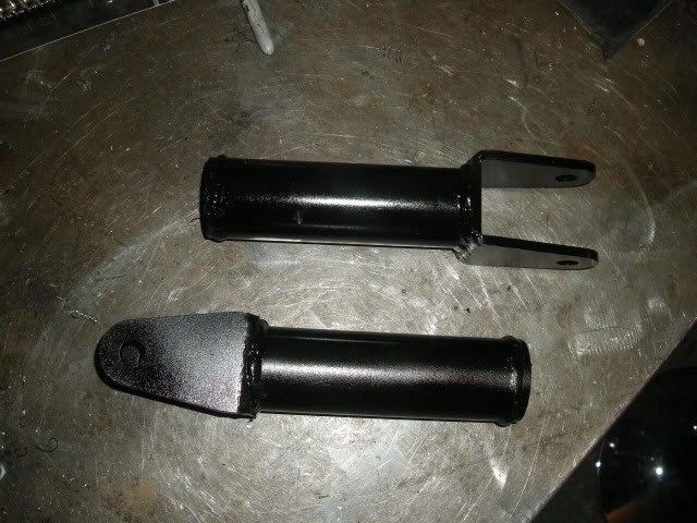

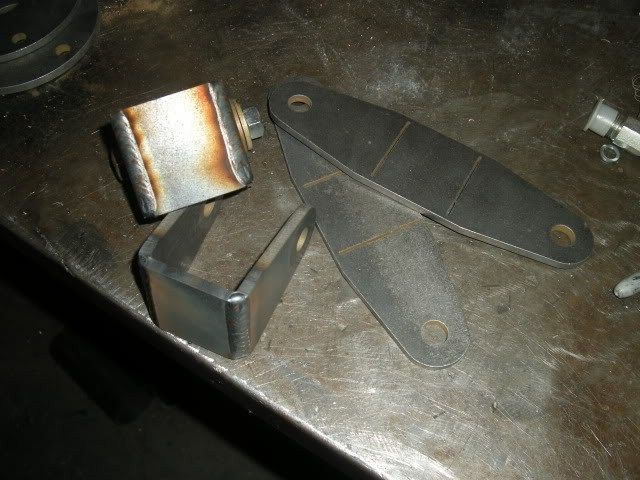

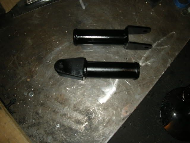

Got some more done today. We will be offering a completely bolt in setup for the Magnums, Chargers, and 300s. All the plates and lower forks are water cut.
