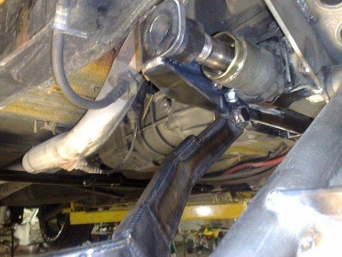

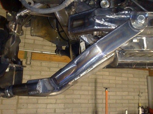

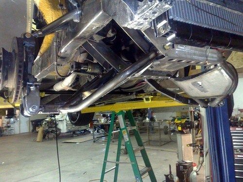

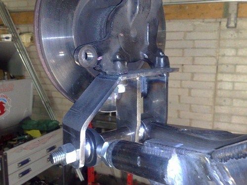

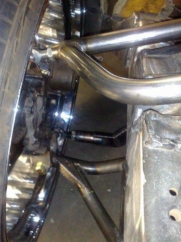

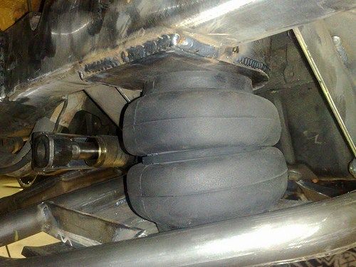

this is the front steup i did on a tacoma that lays pinch on 22s. 15 inches of lift up front with  .5 degres of camber change every 5 inches of travel  has the new airbag it .com slamr 2800 bags. it has a full chromoly mid slide rack setup using the stock rack and pinion. the toe doesnt change at all through the full travel cycle. when laid out it has about 1/2 inch of camber and .5 degree at drive height. also has the bolt in spindle drop tabs made from 1/4 4130 plate the steering tab on it however in just mild steel.

2 pics, thats it? Looks good though.
tacomaon24s's avatar
tacomaon24s

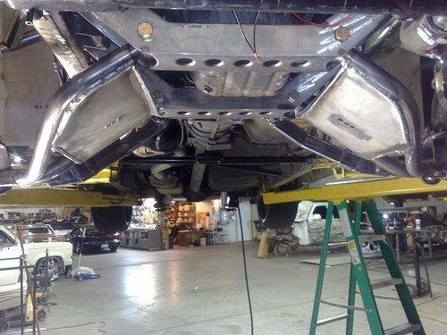

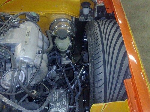

yeah thanks sorry had a crying baby to hold here is some more this is all i have for now.

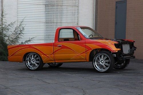

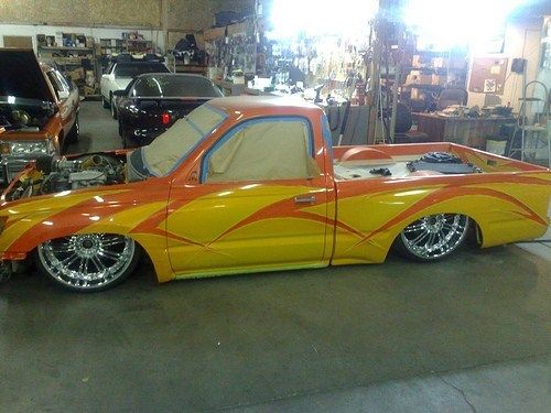

Uh yeah, shit is crazy. Looks badass bro.  Any pics of the truck itself layed out??
TG
the grinch
There should be some picks of the truck under the Perfect Poise club directory deal (for some reason I can't go to the club directory to get the pics)...They may be from when it was on 20s though, but the truck is going to be dope. Looks good Josh

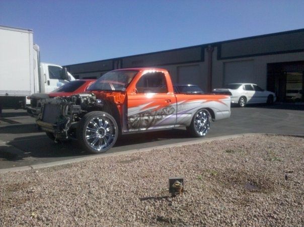

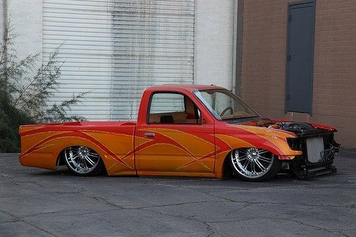

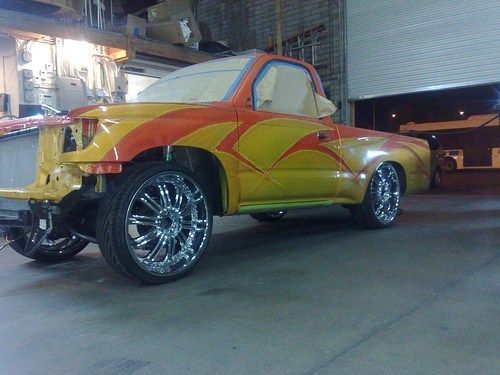

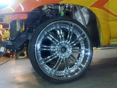

Truck looks great Josh!  People are definately starting to realize that you're emerging as one of the top fabricators.  I found this pic of the truck air'd up all the way, but can't find one of it on the ground.  If you're getting lift / drop like this out of an airbag, I can't wait to see what you're going to get from a hydraulic cylinder!  Anyhow, awesome job!.
PPTACO

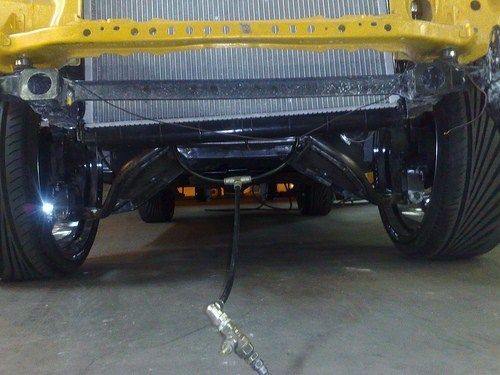

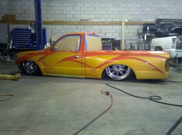

Here it is laid out... kinda together still have little stuff left to do... Thanks josh.

LOL^^^ i get it. Ive always like that truck, it looks even better now. What size tires are on the 22s

it looks great, one question though. it looks like laid out it has tons of toe in? is that true or just the pic or does it need an alignment?
