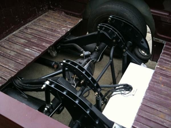

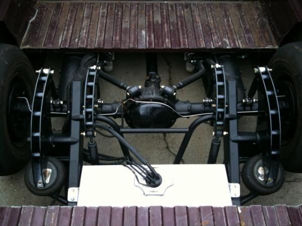

My question kind of got lost in all of that /\ . What kind of locating device are you guys adding to the rear end of that truck?

---------------------------------------------Originally posted by Pizza Box Joe---------------------------------------------Originally posted by flatblackmazdawgLooks really nice. What locating device are you adding? ---------------------------------------------locating device?  its basicly a tri 4 link.......Eric from oOoTBCoOo---------------------------------------------He answered you.... The upper bars are triangulated, keeping the axle centered side to side.

<IMG SRC="http://tbcworks.com/images/479_New_10-21-09_166.jpg"> Personally I don't think that this will work any different than a parallel four link.

It actually works quite well! The mounting points are still the same...triangulated. No different than if the bars where straight. There is no side to side movement at all! AdamTBC
