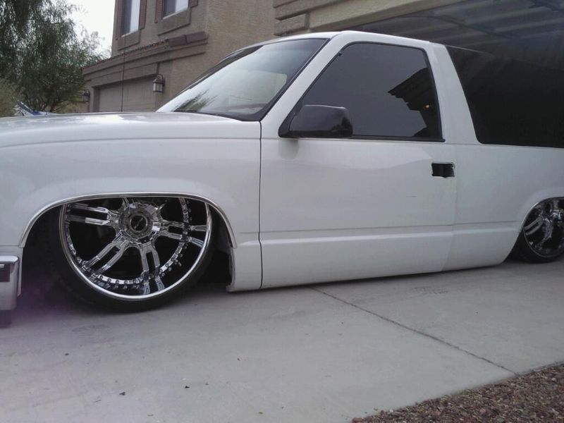

ya i sucks cause all these big wheels nowa days everywheel looks 1 or 2 sizes smaller then they are

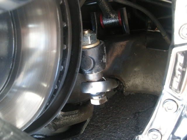

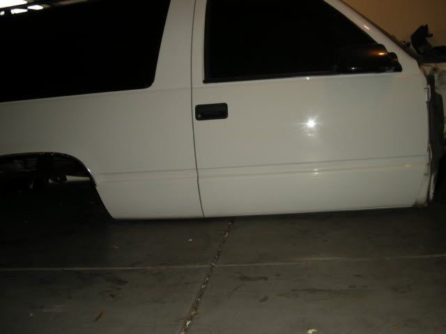

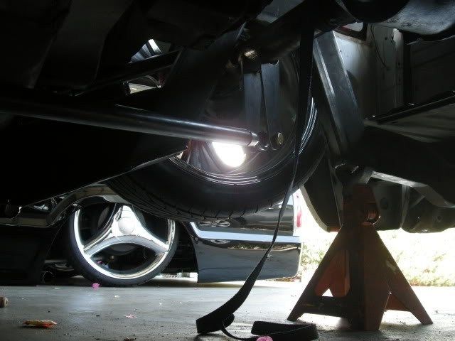

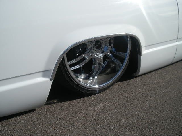

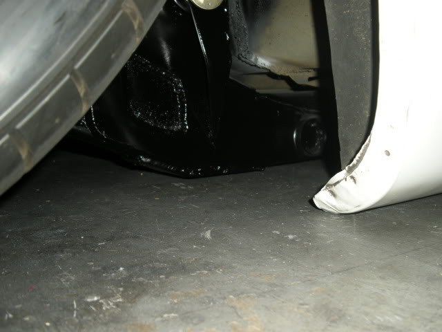

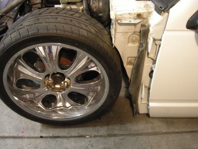

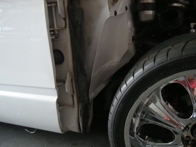

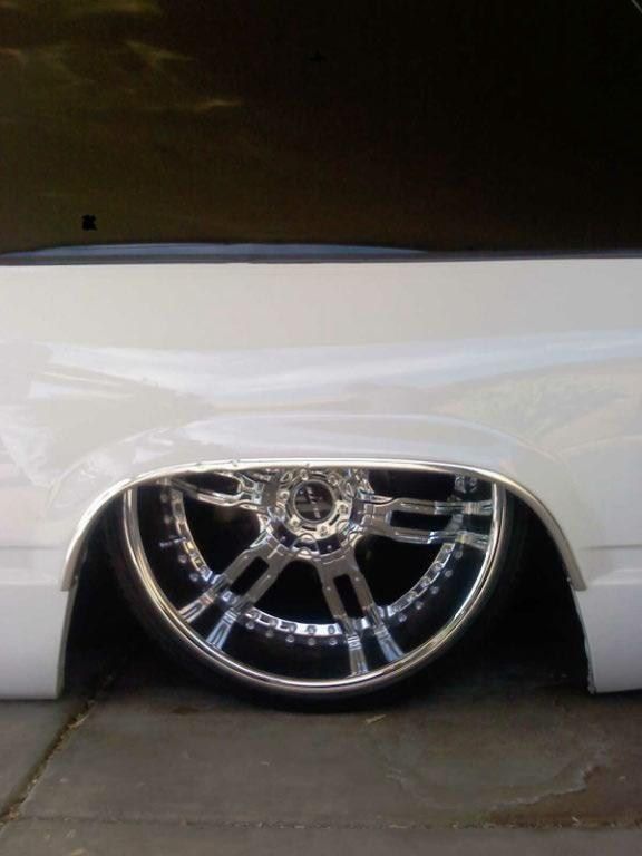

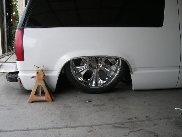

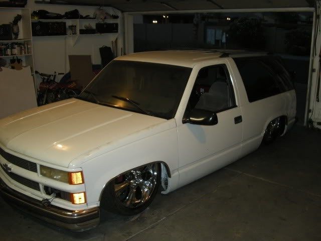

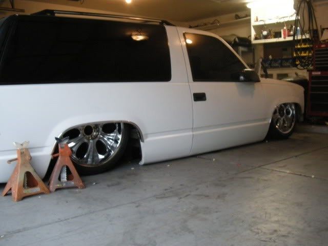

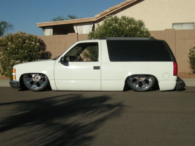

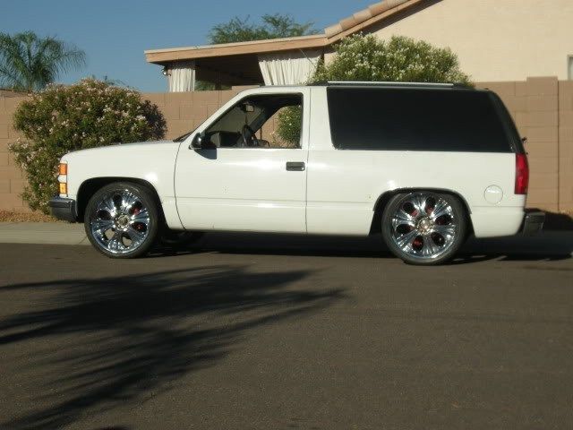

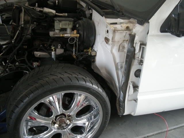

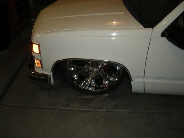

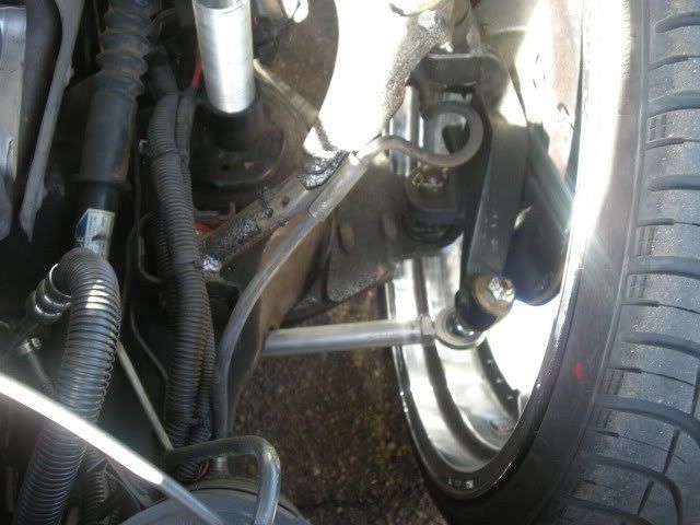

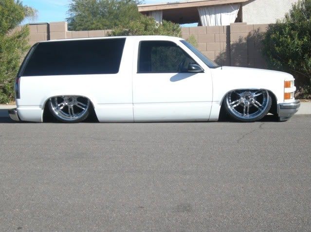

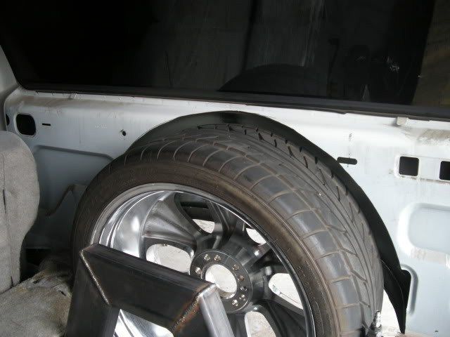

I have been on vacation, sorry for the slow response. It is a flowmaster. The 24's are now on it as you can see. The steering is holding the truck off the ground by about 1/2". So I guess my notches in the frame for the steering were not big enough. I will be doing a heim and drop down on the spindle to cure the problem.
tre5's avatar
tre5
some more pics...

damn guys looks super good lays hard too!!!!
