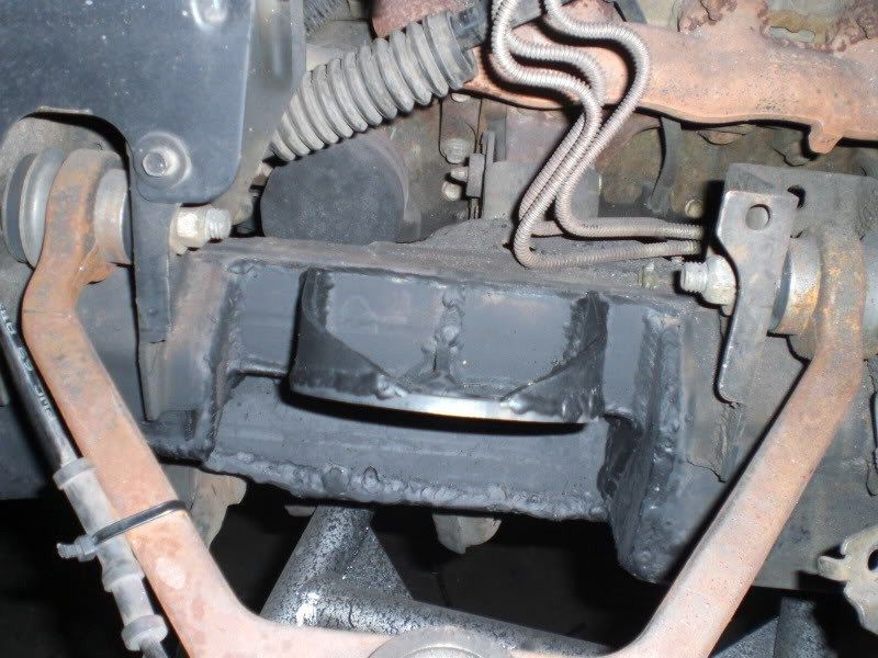

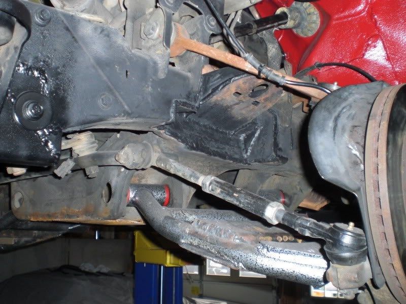

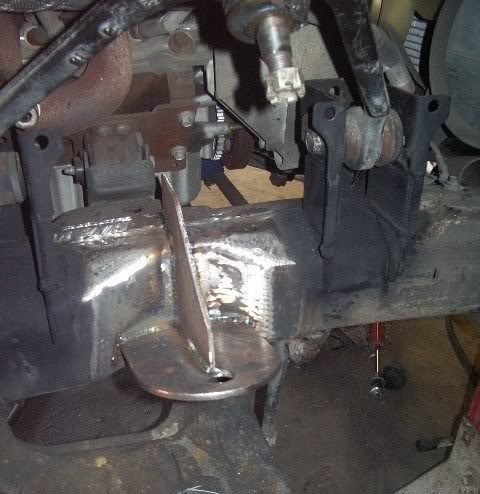

Edited: 1/11/2009 8:40:43 PM by bagtodragF150 and expedition its all the same, raise your upper arms, flip your arms left to right to left, flip lower ball joint replace with joints, flip tie rod ends, ditch spring perch and use a plate setup and modify lower arms. Just like mine was done....

Well as far as flipping the lower joints you do just that, flip them upward. you have to ream the lower arm then press in the new joint. Mine where raised 2" but some raise them 2.5 or even 3".  Its alot of work but its well worth it in the long run, eliminating about 95% of your bump steer, reducing camber and the reduction of messing with your firewall if you laying frame on 22s.
