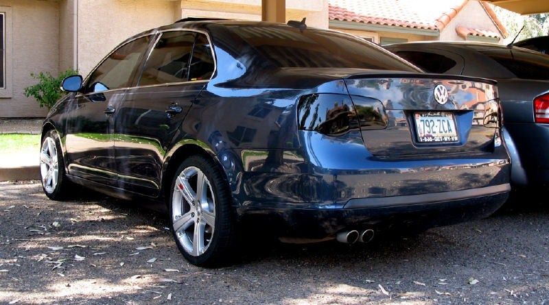

i did all of the above lights with clear and only a few drops of toner black.about 4 coats to get the desired look i wanted and then two coats of clear for wet sanding and buffing purposes.

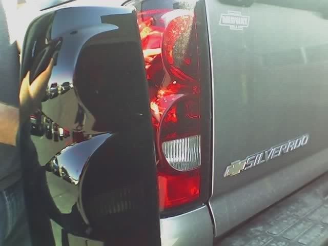

i didn mine on my truck and i just wetsanded them with2k grit paper....and mixed a little black with some clear and sprayed about 8 coats....i used mineral spirits i think it was called to cleane them with

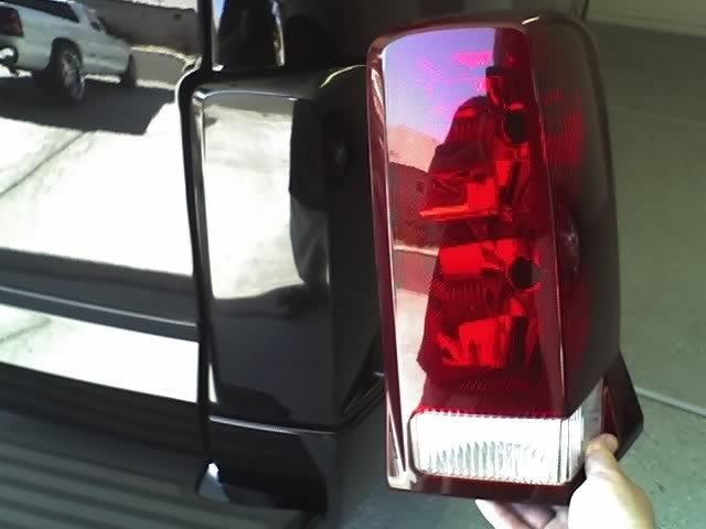

my clear "fake" caddy were i guess illegal so i took some candy red, and well the reverse light still shines clear as day through the red candy so im guessing if you dont lay too many coats of the black tint then the same thing should happen. a female friend of mine was slick and tried to tint her tailights using actual tint, an a for effort but the results looked like shit, and for the half the price she wasted on tint you can buy a can of tinting just for that purpose.
