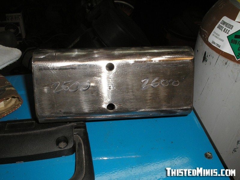

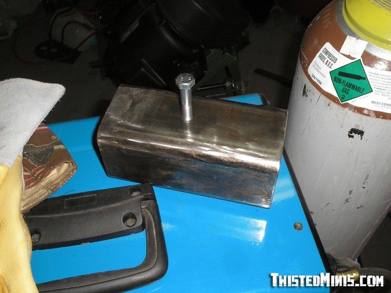

I made a bag jig for mocking up airbags.
One side is 3" to the center of the holes for a 2500, or RE6, and the other side is 3.5" from the center of the holes for a 2600 or RE7. Just set up to do slams reallly, but it worked out perfect.
