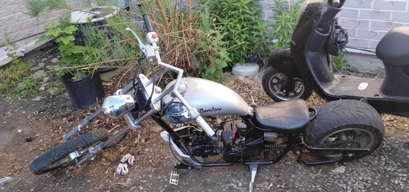

I got a few pics of the 2 i built they do 80 definilty awsome

hey......i really like those bikes you got there. theyre a lot different then the ones that use go-kart wheels in the back. do you use an xr-70 or something like that and build your own frame?

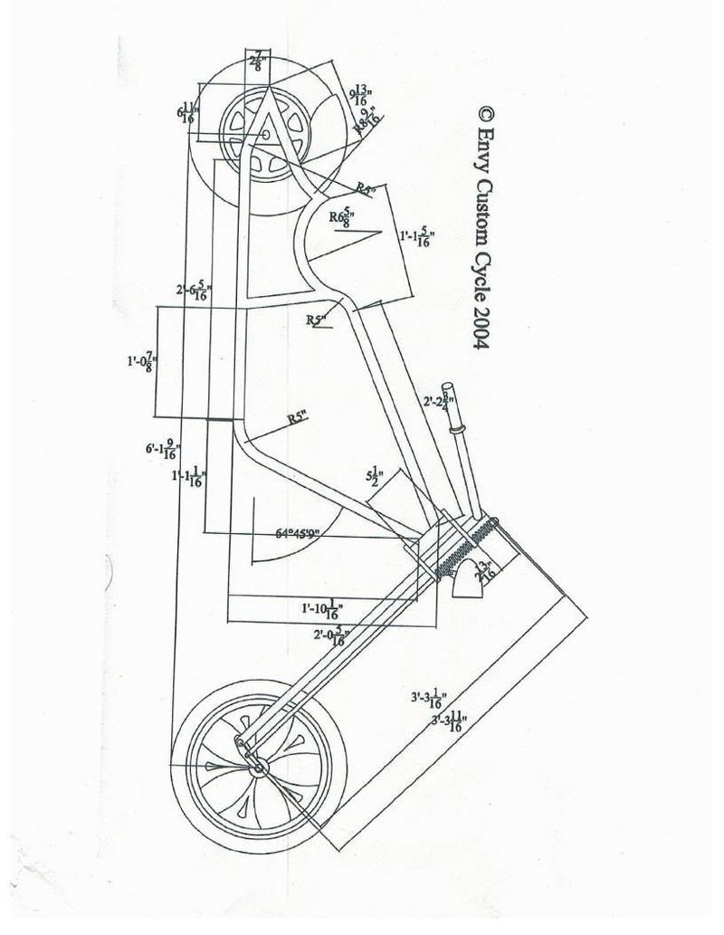

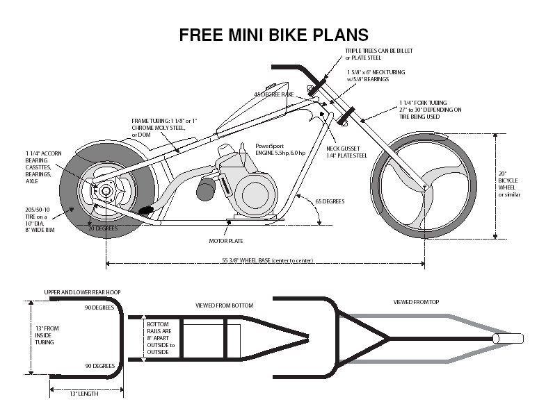

I've built a few. Look at my profile, I have pics of 3 of them.
Here is a set of plans a friend of mine did in AutoCad.
And here's a simple, free set.

hey aleinwerks3 yea they are xr100 motors beefed up a little they are the xr rims and we found 140series streetbike tires fit on that rim
