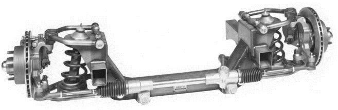

i know you've seen these before but they will take care of any caster adjustment. The trick is to build a control arm that needs no adjustment.
You can still use straight rod ends and adjust for caster if you use a strut type mount on the frame. check out the picsnot exactly the same, but you get the idea:
msturg's avatar
msturg
as long as you don't move the ball joint location over in the x axis just in the y axis and z axis you should have to worry about caster. that is if you were to put your origin on say the lower left ball joint in the bottom pic above.
Whereas I would think with heims they would be able to move the entire control arm front to back, in relation to the frame.
