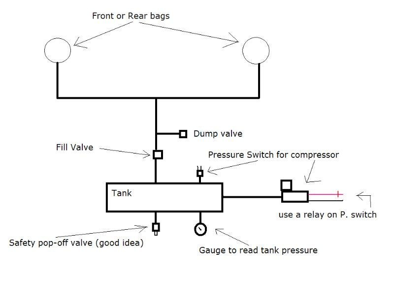

i had thought about doing it and in the long run your not gonna save much 40 dollars for 2 check valves or 32 for one more valve unless you got check valves laying around i would just buy one more valve also you dont need to run both lines to a tee and go right back to the tank you can run both lines separately to the tank

If you take out each of those dump valves, and take out each of those check valves you can use one fill valve to fill both bags and put a "T" fitting on the fill line between the valve and the bags with a second valve to dump the two bags. This way you can use only 4 valves all together and have front up/down & back up/down.
how would this work can u draw a diagram

BIGRIGZ
I'm working on a diagram for ya right quick....
BIGRIGZ
see if this helps?

Originally posted by BIGRIGZ
see if this helps?
if u do this the bags will make ur truck sway back and forth thats why my first idea had 1 fill two check valves and 1 dump for each side.

Originally posted by toadfrog17
Edited: 12/24/2005 7:25:17 PM by toadfrog17
Just put check valves in front or after the fill valves.
I don't know anybody that has a system setup with only 4 valves. I don't know if you have your swaybar on if it will sway or not?
Everybody I know runs at least 8 valves...

Just go with the 8 valve setup bro its alot better ride plus you can do more. Like someone said for the price you spend on the check valves you can get ya some other valves.. we have Asco valves for $25 their on our site..

i have a four valve setup right now just front up/down and rear up/down the only reason i did this was because my friend had bought a bd'd nissan and needed valves so i lent him mine and im supposed to get them back this week and it doesnt sway (that bad) if you have it at the right pressure which is semi low but evesince i had the setup i wanted those four other valves back cuz sometimes crusin down the road it can get a little wobbly imo get the extra valves and do it right the first time
