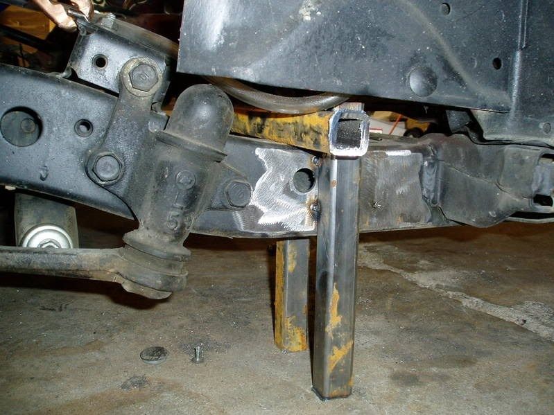

kindalow
my oil pan and tranny bell housing were both hanging below the stock rails so sectioning the stock control arm mounts would have caused me to have actually have to raise the motor or build a new pan just to lay frame.
Z'ing a frame is simple as long as the motor is out, or the cab is off. the only real hard part I found is welding the inside plates onto the side of the rails while the motor is in place. if the cab and motor are both in place I would think it would be incredibly hard to weld the plates to the inside of the frame rails, but Im sure someone on here would disagree because they always do.
kindalow

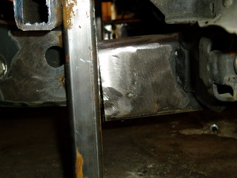

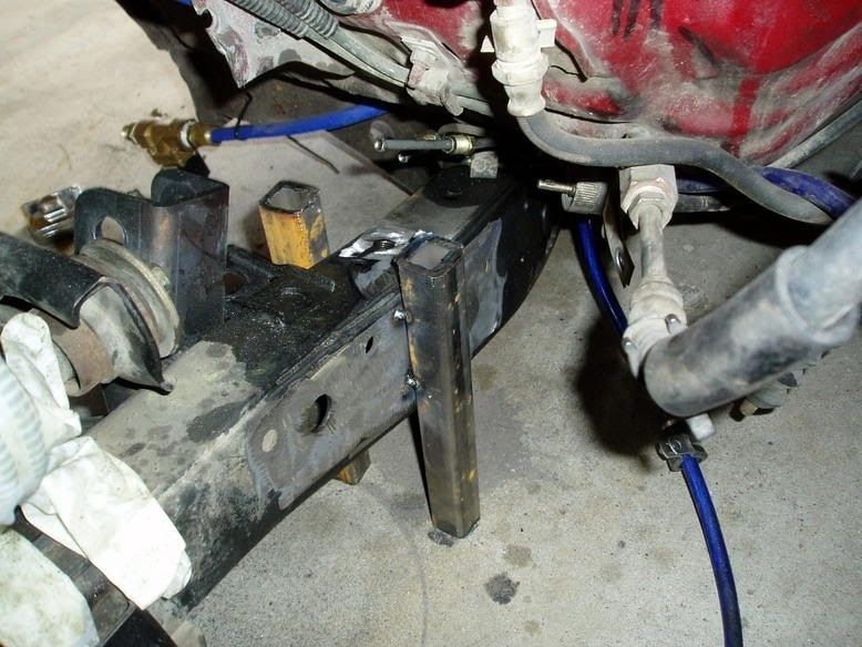

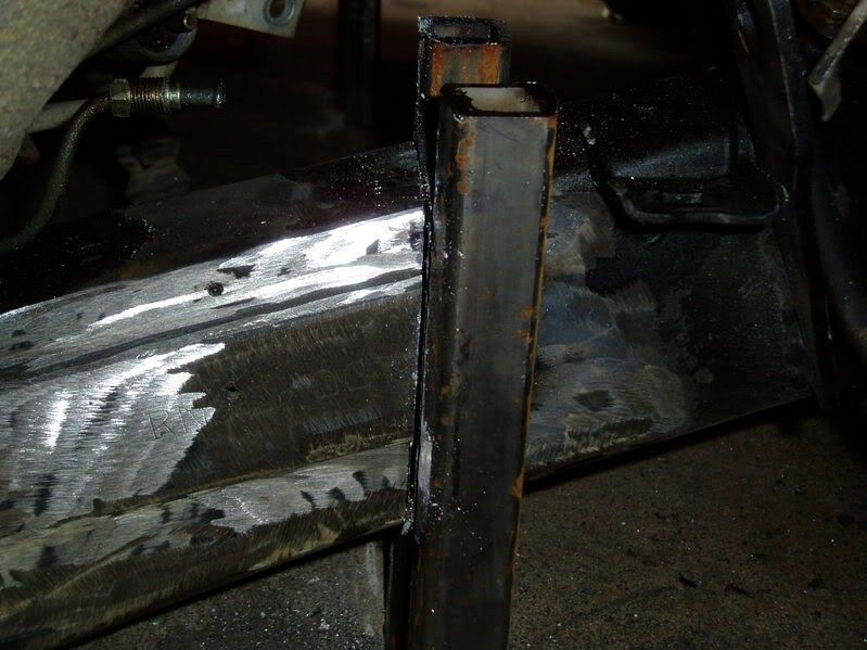

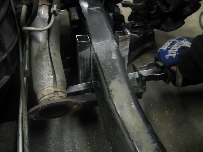

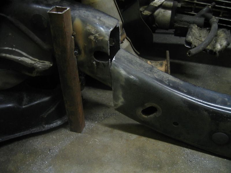

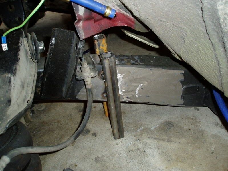

heres some more Z'ing pictures from when we did Miles rodeo, this method worked great for keeping it all aligned and straight.
