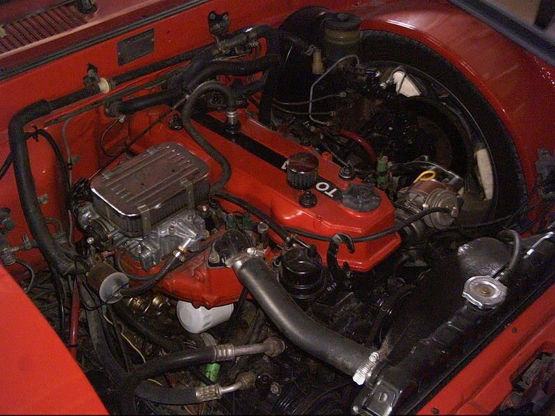

nearing completion on my carb, just need to know these last few things:
Where does letter A hook up? the one below it also...
For B, this is a little vacuum thing coming off the intake just under the carb, wth is the point of this? can i just plug it?
C: I ordered my parts from weber and i guess i forgot to order the block off plates. can i just plug the lines coming off of this, or should i take the whole thing off and just block the holes (i have spare metal and could make block off plates if i need to.
D: and this is a biggy, I pulled this line and have no clue where it goes, it comes from the brake booster, but i cannot remember for the life of me where it hooks up.
can anyone help me lol, pictures would be best, but if you dont have them, i have enough mechanical knowledge to figure out what you are telling me.
thanks, in advance.

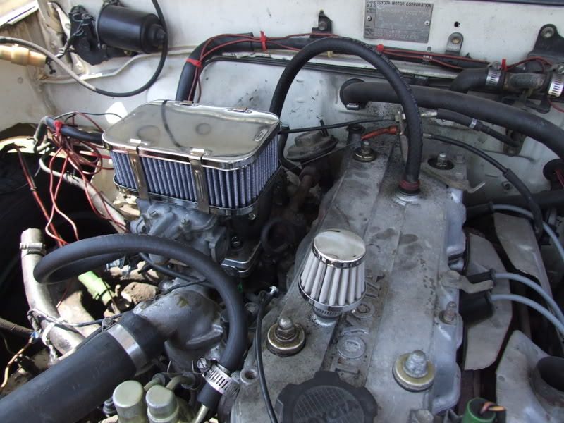

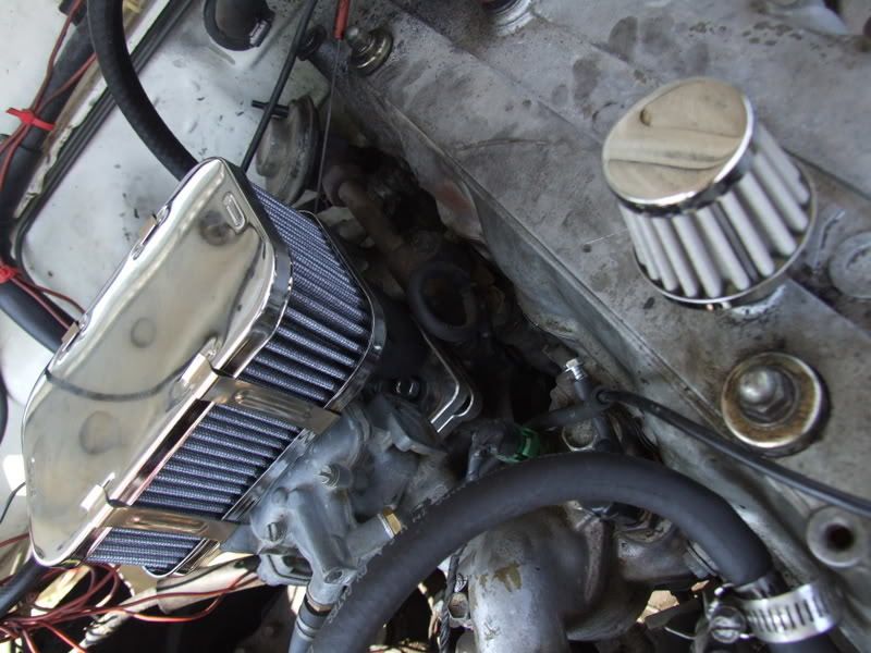

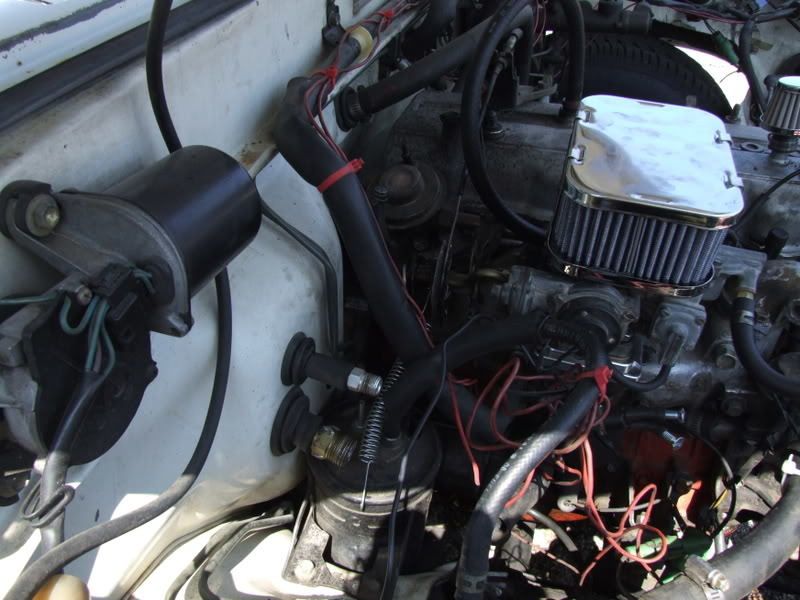

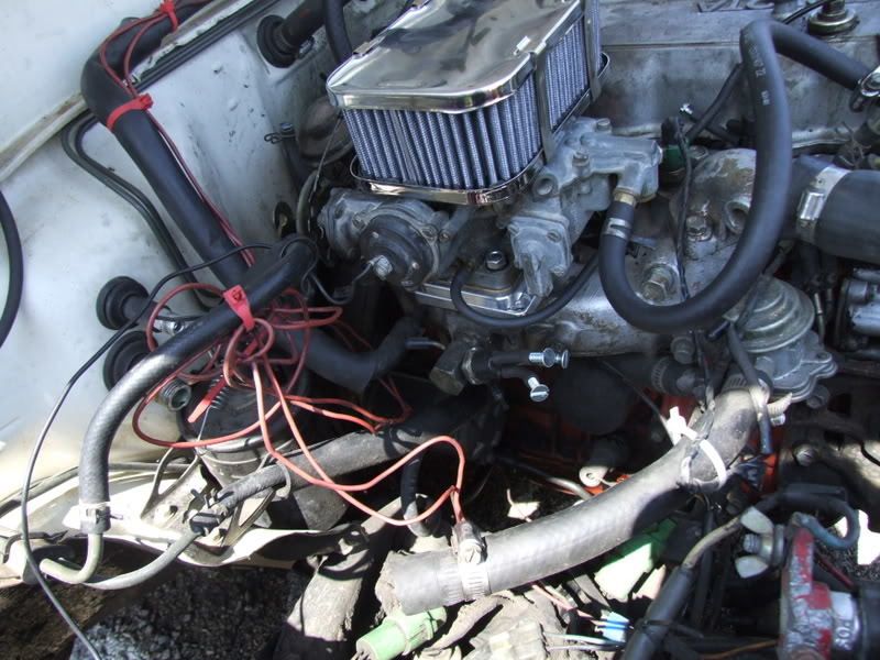

Here's mine, even though you can't nessesarily see everything too well. I did not want to have to block off the EGR at three different points so I just capped off where the tube came out into the intake. You can see where the PCV goes into a fitting that weber supplied with my kit that bolts on where the EGR used to go.

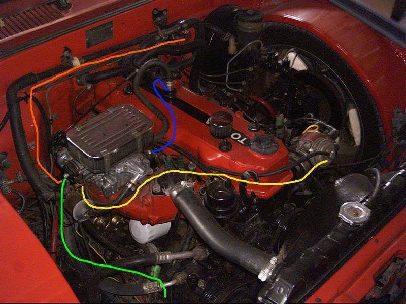

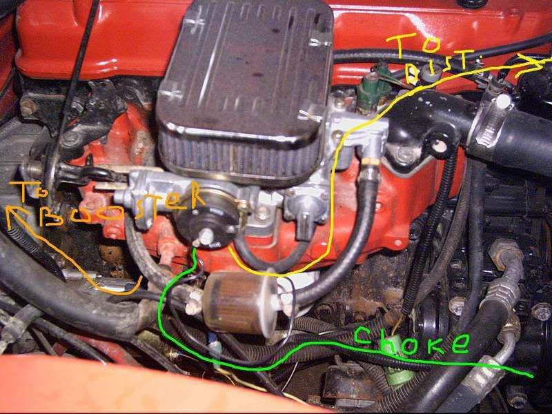

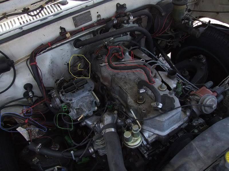

OK here is my set up as promised. Now mind you i don;t have a stock intake but it is rather similar.
I tried making this simple.
Green is the shoke hot wire, kook up to your factory riring that goes to the carb.
Blue is from the PCV to the bottom of the air cleaner set up.
Yellow is from the single vacuum port on the carb, it connects to the port farthest from the engine on the Distributor. Cap the other off to keep dirt out and from losing vac.
Orange is from the lower side of the intake (large nipple) to the brake booseter
Plug from the main harness to carb. Your weber carb will use a male spade to connect to this. Use some dielectric grease to help with connectivity and keep moisture out.
On all the other vaccuum ports make sure they are plugged, if you have any vac. leaks it won't run right.

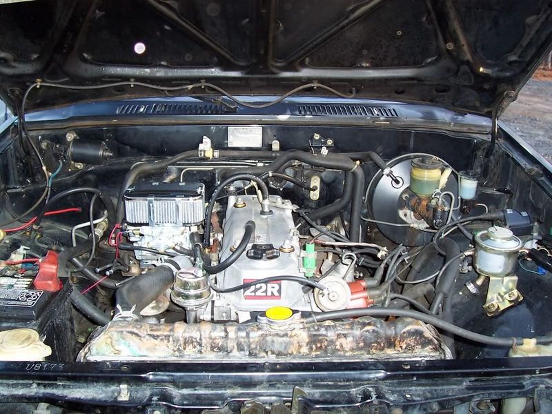

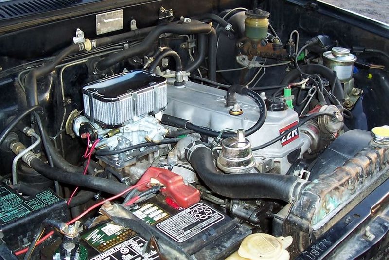

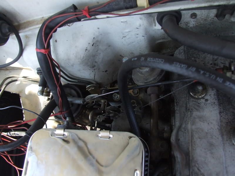

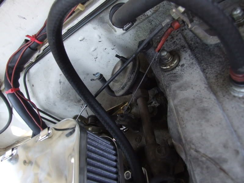

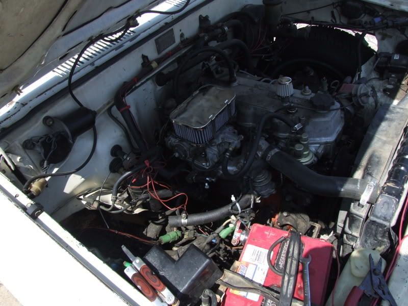

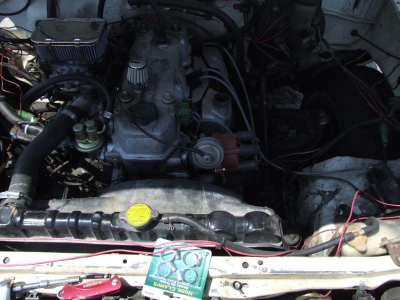

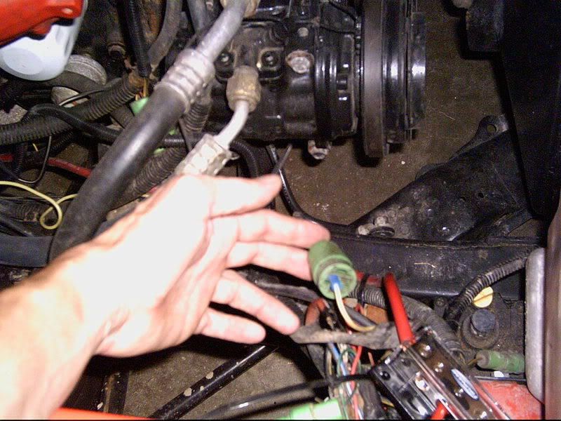

ok, got everything hooked up....truck wont start... here are pics, anyone help me figure out whats up???
