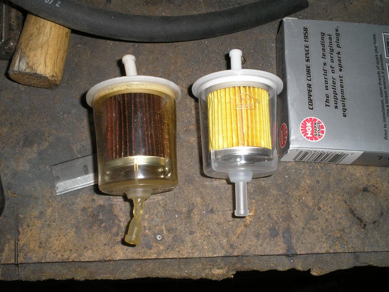

I replaced my fuel filter too, old one was nasty, but it made no difference either.

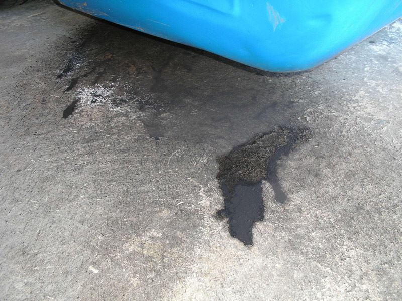

And heres the black shit coming out of the pipe. The small dark patch is the freshest as I moved my truck back a foot.

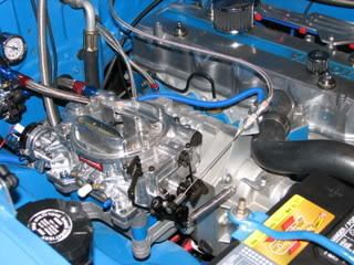

Seth, maybe it just needs a good high speed blast to clean things out, It still may have some over rich carb problem thats getting overlooked. I gave my best shot with no hands on, which can be hard sometimes.
Just so you know your not alone, I have had a few carb issues myself.

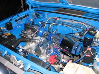

I did a few mods on my rig this winter, can't ever leave well enough alone, upped the blower boost, definately felt that in the seat of the pants, swapped the 2bbl carb for a 4bbl, then in the 30's degree weather started having some carb icing issues, the carb sits so far to the side it doesn't get much of any engine heat, top that off with the funcitional hood scopp blasting more cold air under the hood, and the carb height, had to raise it nearly 4 inches to clear the blower, kinda acts like a tunnel ram with lots of surface area under the carb to cool, so it would ice up and crap out going down the road, I removed the K&N filter I had on it and did a little creative air cleaner plumbing and came up with my winter version air filter, works like a charm now, in fact I might be able to run it in the summer too by just rotating the heat shield so it gets cooler air from the hood scoop, we'll see how that works out. I never claimed I wanted fuel economy

That is an immaculate engine bay. My lord. Lol.
