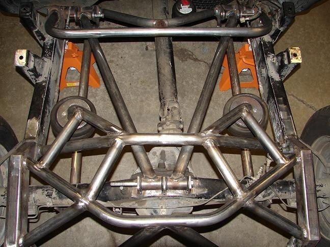

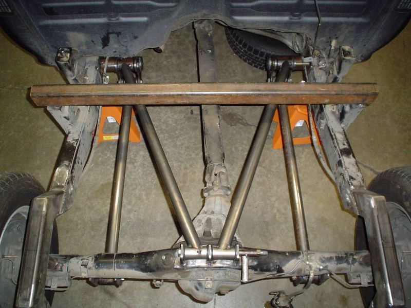

done with the fab work just need to put shocks on install the fuel cell and paint it

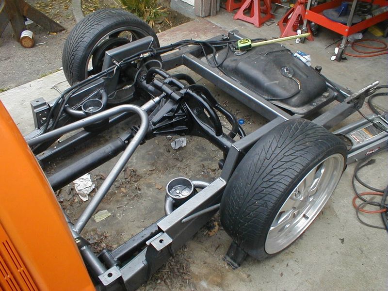

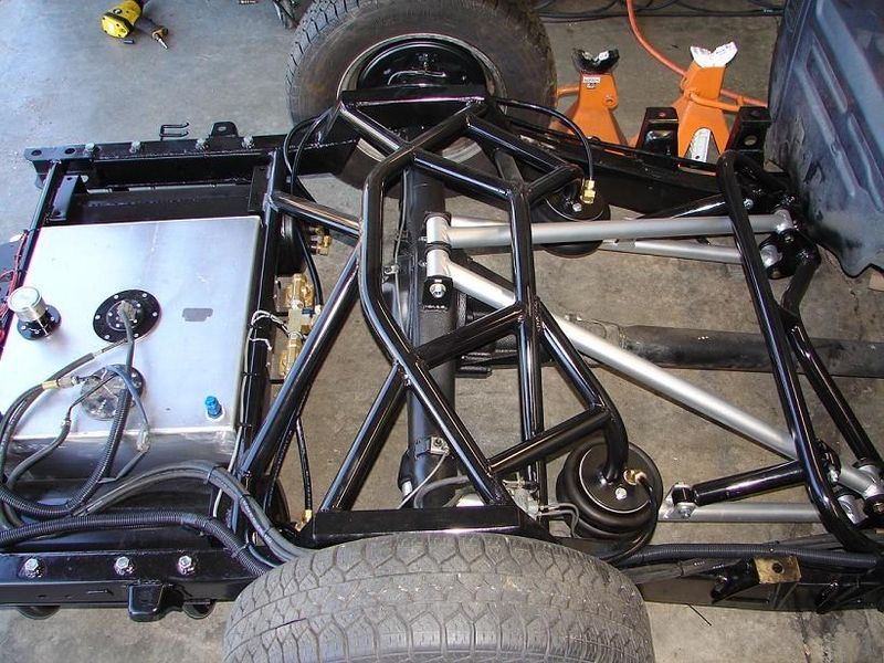

How about a full forward triangulated with the gas tank in the stock location......just get the gas tank evacuated to get rid of any fumes.....notch the corner of it so the 4 link bar will not hit it and weld it up....have the inside of the tank recoated by a gas tank repair company and your done.....

Thats exactally what i did on my fullsize, but i also sectioned the tank 2 inches.

did a mazda that way

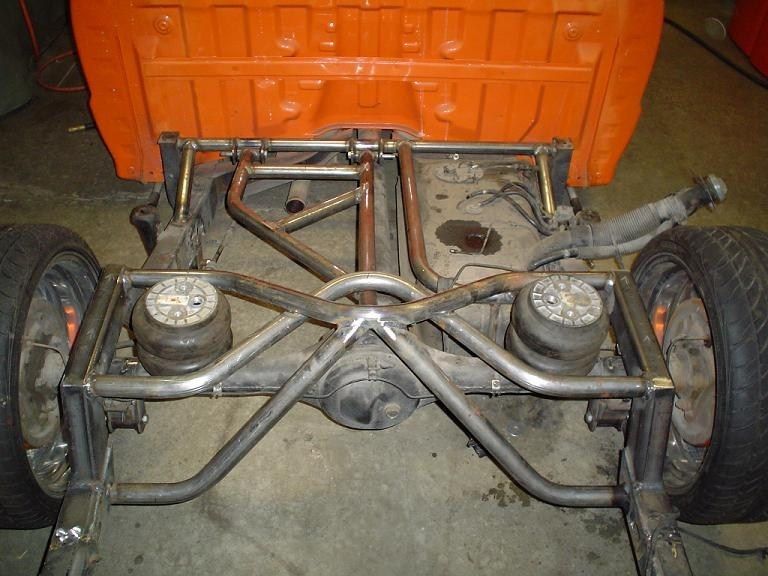

Would love to see more pics of tri four links on here!

How are you guys prepping those gas tanks to perform all this??
