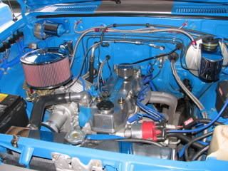

just for you my little project B&M blown 22r bored .030,crane cam and spring ,holley carb 350 cfm , headers [/quote]
Its looking good, have you had a chance to drive it any? What other internal mods did you do to the engine?
So far I,ve been happy with the setup on mine, have logged nearly 4000 miles with no problems

wow it's the second supercharge I have seen very nice.
I just did keep it simple for now when i sent the block out it's was a&e piston and balance for the head i did not put to much money on it because i am thinking about getting a 20r head .
So far I did start it and it run fine but I did not drive it yet and I had that in a older toyota 4x4 many years ago i was 18 at that time heheh.
I try to fire it up the other day and now I dont have any spark coming out so I am thinking about upgrading all my ignition but i dont know what exactly to order it's been along time i had that sitting around.
I am thinking about getting a electric fuel pump too.
I dont know how it will run in a 2 wheel drive toy yet
because i am bagging my truck right now so i am very anxious

Once you get it on the road you'll have fun. The swap to the 20R head I might question, but its your truck so don't mind me.
Just for what its worth, the 20R head uses a different intake manifold than the 22R, close but still different. The 20R head has smaller valves and the combustion chamber shape actually raises the compression up about a half point when swapped to the early 22R block, not a great thing when supercharged.
The ignition upgrade is well worth the work, that was one of the first things I had to do when I got mine running, the stock ignition worked , but at idle the engine would load up terribly, at higher revs it would just get lazy. Basically with the pressurized cylinders the flame was just to weak to fire the fuel mix, went to a full mechanical Mallory distributor, coil, setup and cured the problems.
I built mine rather conservative on the boost pressure, 6#, but concentrated more on building the rest to be dependable. Started with an 88 22R block, bored .020 over, forged blower pistons 7.5-1, balanced, dual timing chain setup, hiperf oil pump, big valve 22R head, Shnieder cam, header, Holley 500 cfm carb, full ARP head studs and bolts, windage tray,dual oil filter setup with cooler, and a custom 3 row H/E radiator pretty much rounds out the under hood fixins. Good luck with yours.
