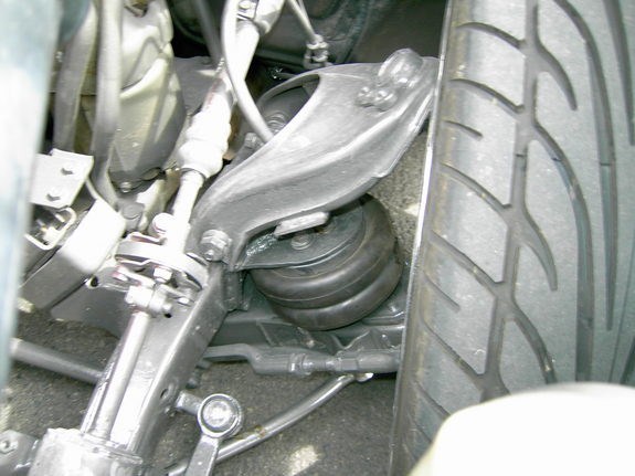

Hey russ, that's without flipped and spaced balljoints right? do you think that i would need to trim my lowers to clear frame with the balljoint mod? thanks for the pic, i like the spacer idea, i'm gonna do that
-mike
dssur's avatar
dssur
the owner if that truck eventually flipped his balljoints, but you can see how tangelo toy allowed room for that by spacing the lower mount up a hair.
Everyone tries to sqish a bag in there and line it up. using the spacer tack welded in there is so much friggen easier. I like working smarter, not harder.

hokieyota
does this help?
