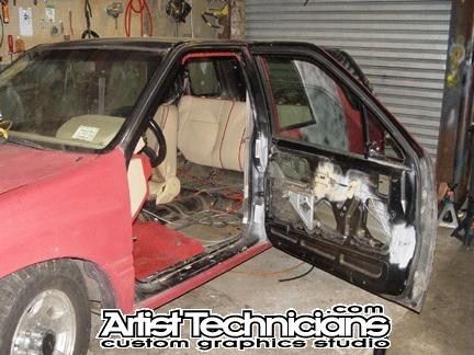

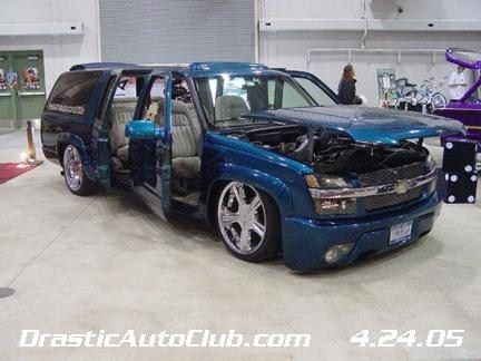

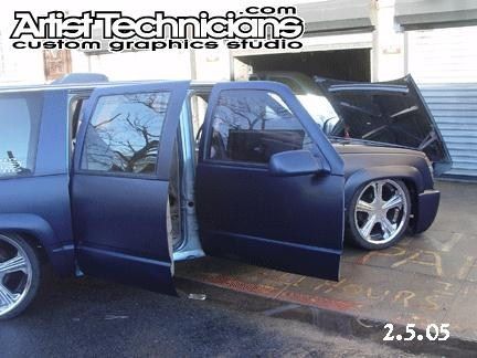

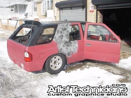

i did all 4 of theese doors with stock hinges. much better & stronger than any hinge kit! i'll never use a kit again.....
Gotmods1
i don't have closeup pics of the hinges i'll try & get some up. any questions?
mpeace
well the stock hinges I used works just like the kits. That one above is the first one I've seen like that.
