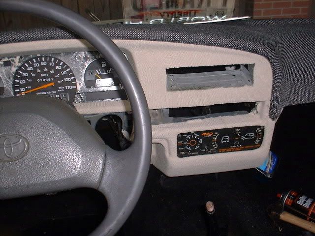

I have retrofit the new dash into my 85 I think I used a 95 dash in mine.Im still in the process of doing it but it will fit......mine is shaved and molded in diffrent places but over all it will work.Here is a couple of shots of the set up

i see to different speedos which one are you using? u musta got the one that was from a 4x4 in the mountains w/ da altitude, rite? i think ima try da 2wd dash

Yeah thats my clinometer......it adjust to how Im riding in the truck so when I got the back down it shows the beack down and vice versa its just something fun to have in there cause no one else has it.Im using the old 84 cluster in the dash the new onehad some issues not being able to hook up to some of the electronics and also I didnt have a manual wire speedo only a electronic which is in the newer ones.

that clinometer came out of my 84 4-runner,,,,i donated to Rodney for the Project,,,it really works like he says,,,when he is cruising he uses it to get the ride height angle that cruises best. its the shit
