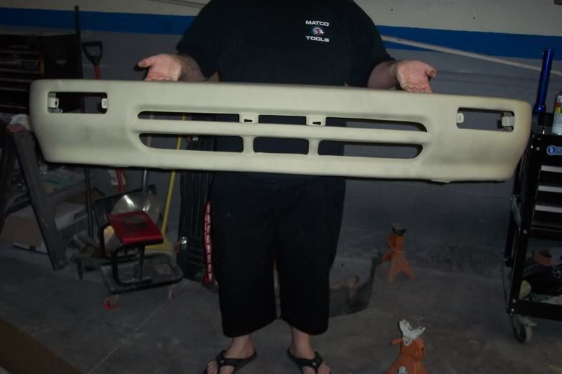

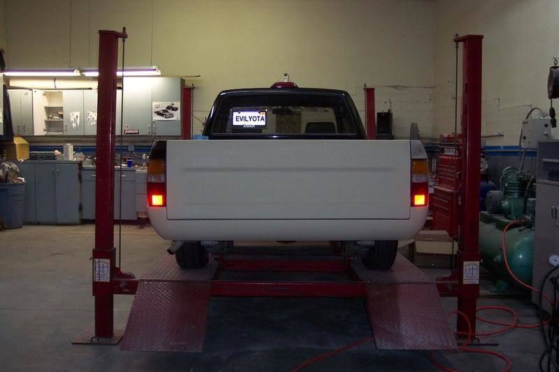

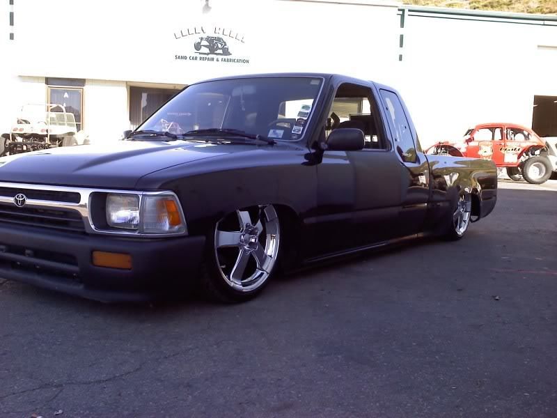

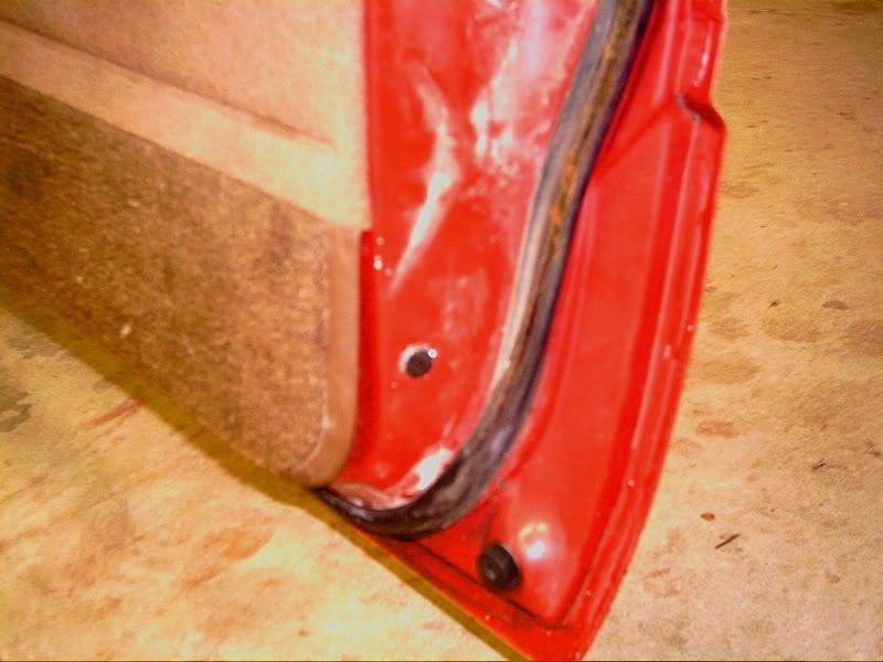

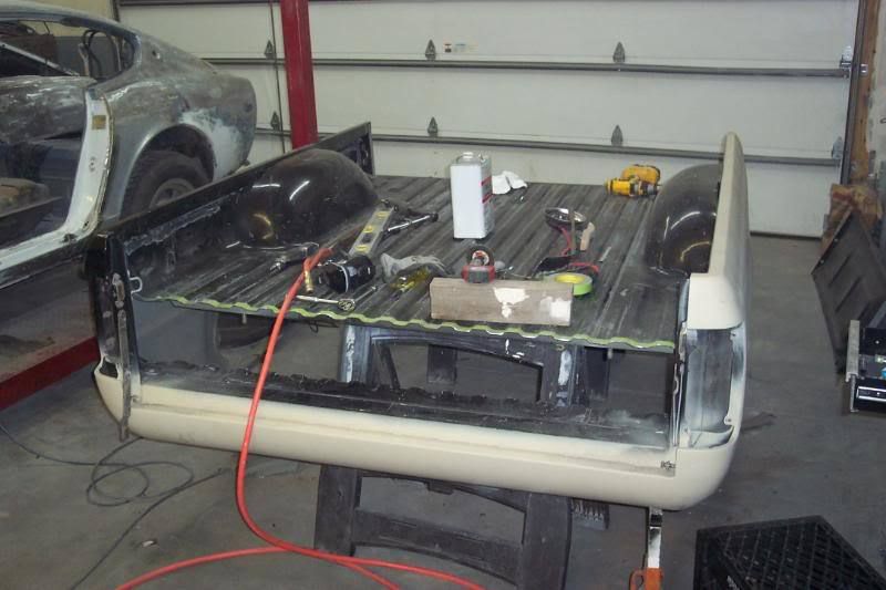

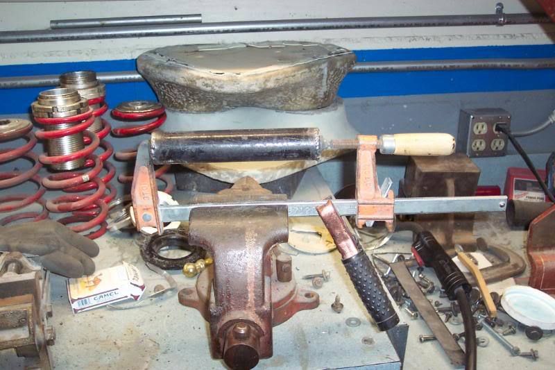

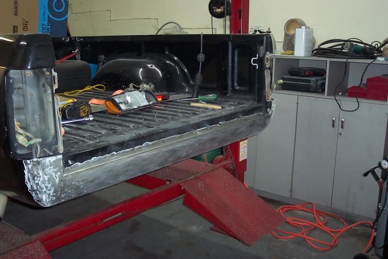

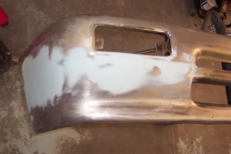

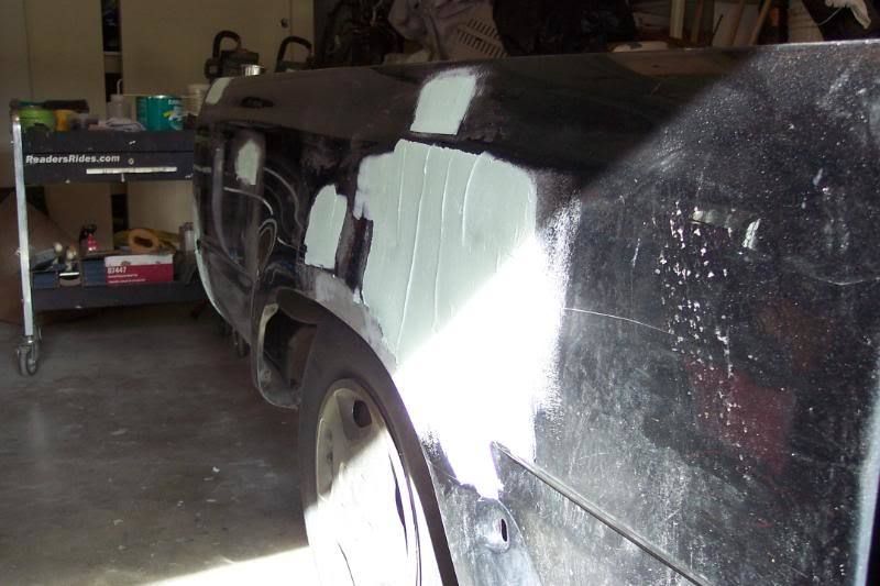

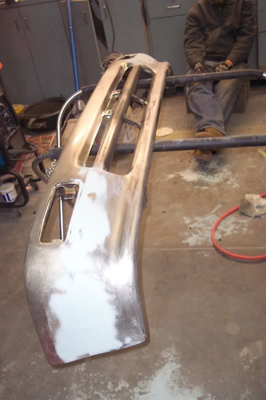

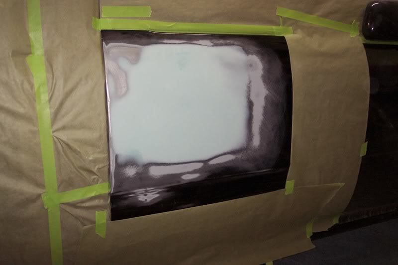

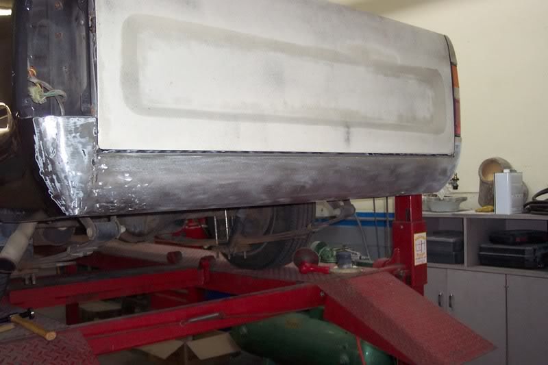

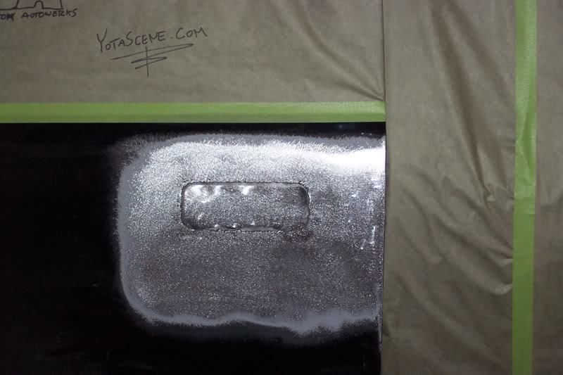

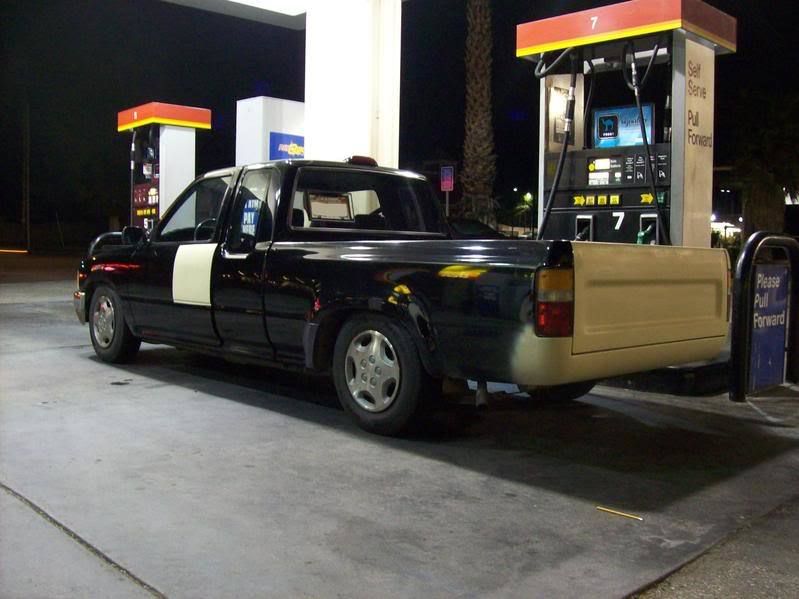

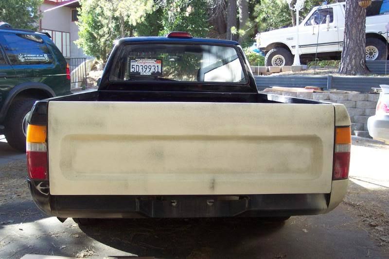

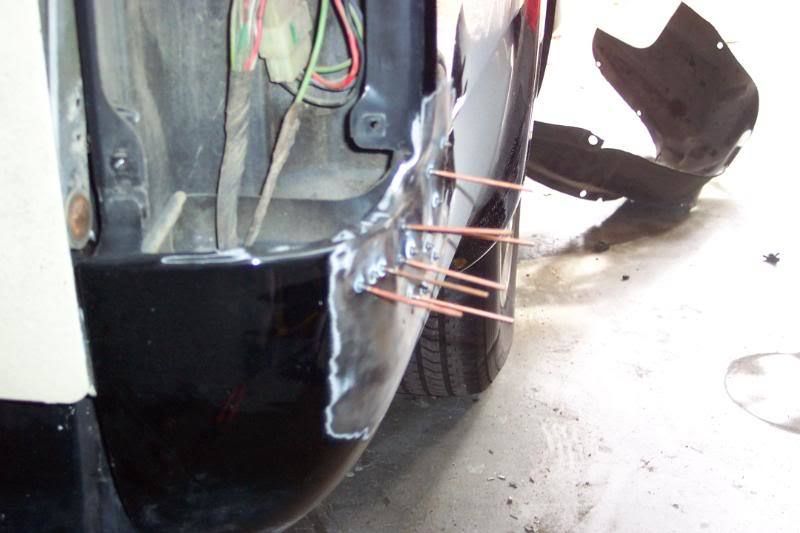

WELL I FINALLY HAVE THE TIME TO UPLOAD SOME PICS OF MY CURRENT PROJECT. ITS SLOW PROGRESSING BUT TS PROGRESSING.... RIGHT NOW IM WORKING ON THE BODY WORK, AND INTERIOR. WAITING FOR WINTER TO BE OVER THEN TIME TO BAG AND BODY DROP HER..... LEMME KNOW WHAT YALL THINK....
NOW FOR SOME BODY WORK PICS....
I GET SOME MORE UP LATER LEMME KNOW WHAT YALL THINK.....

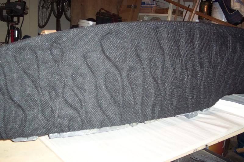

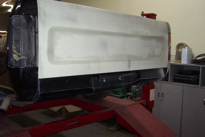

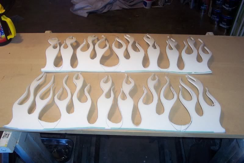

WELL HERE ARE SOME MOREOF WHAT I HAVE DONE LATLEY.....

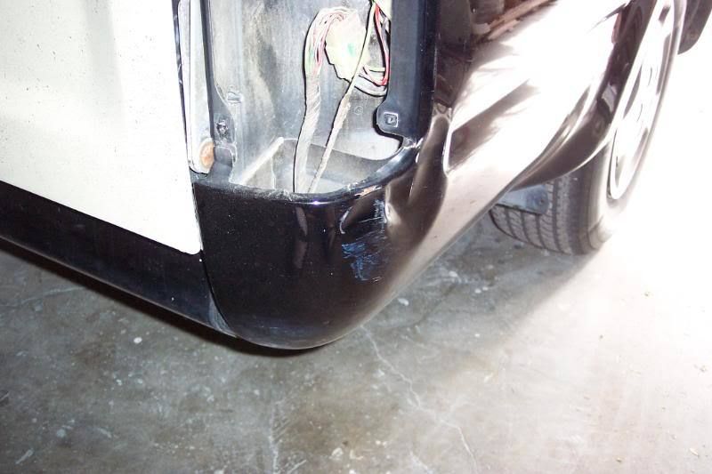

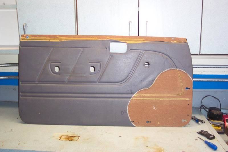

CANDO WINDOW LOVE IT,BUT THE COPS DONT..HARMONIC BALANCER!!!!!!

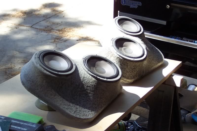

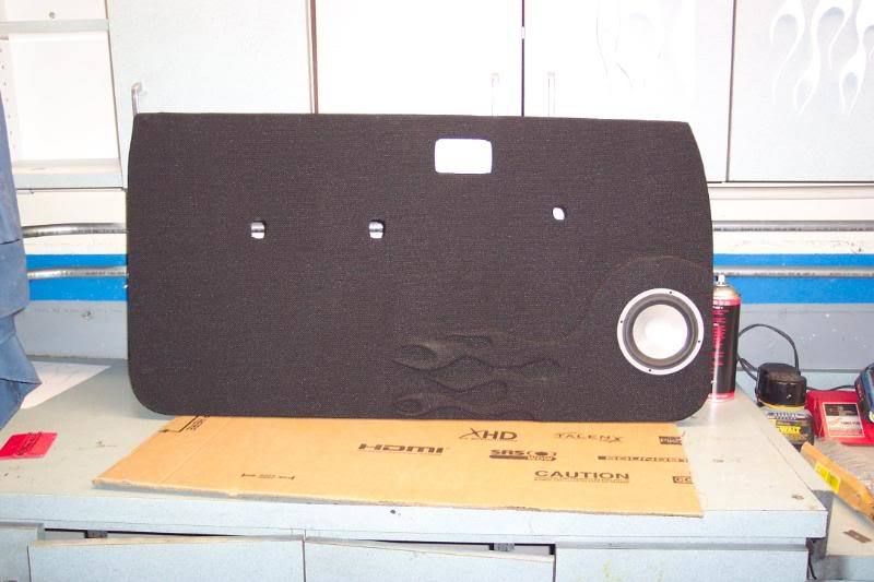

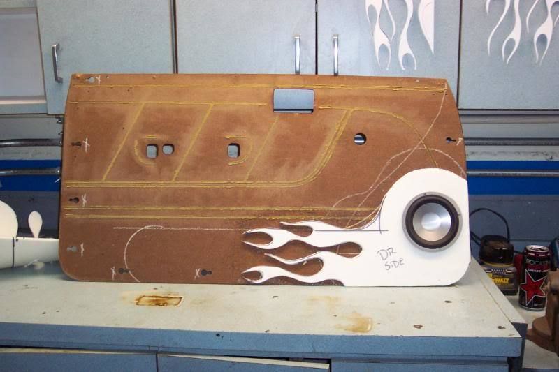

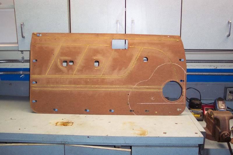

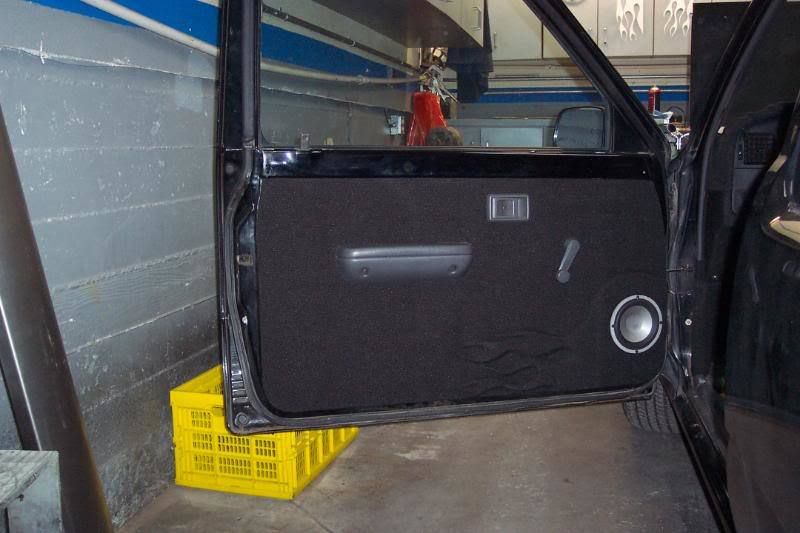

ORIGINAL PODS I MADE FOR THE DOORS, TO FUCKING BIG AND I DIDNT LIKE EM...
SO I REDID THE DOORS...

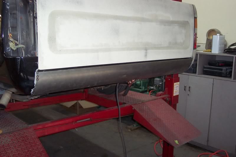

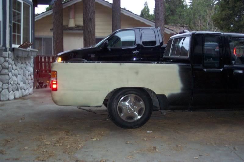

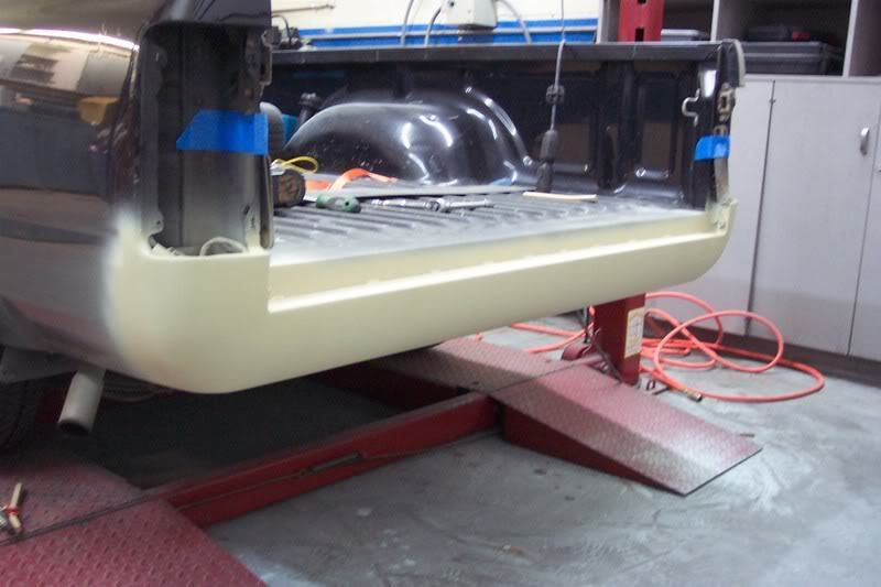

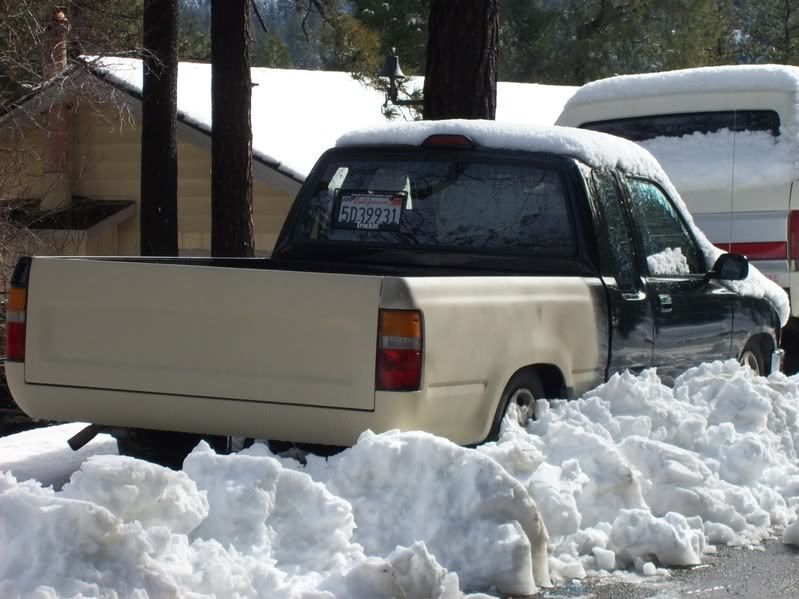

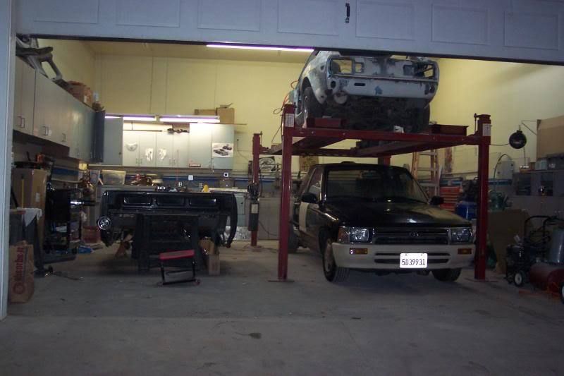

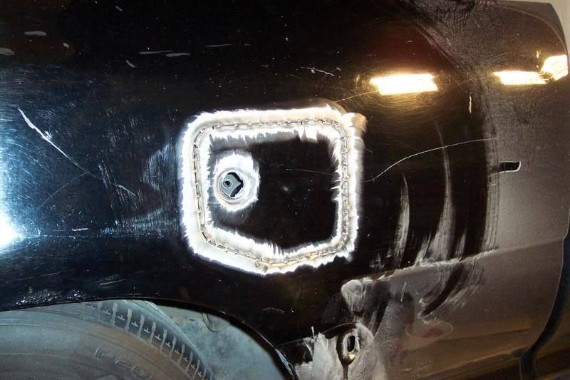

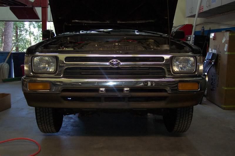

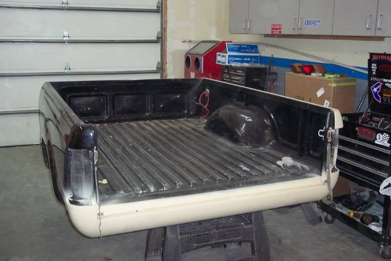

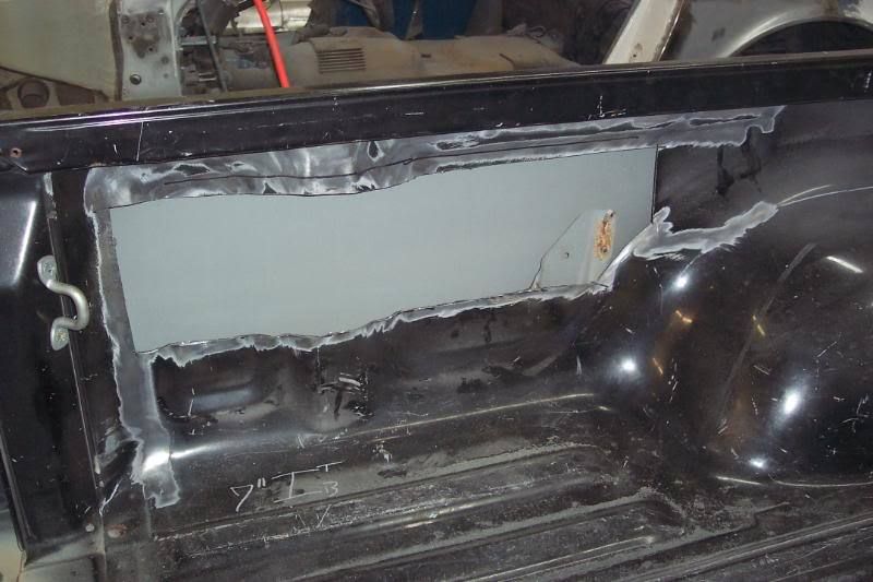

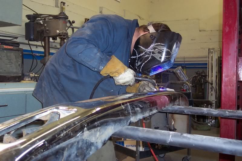

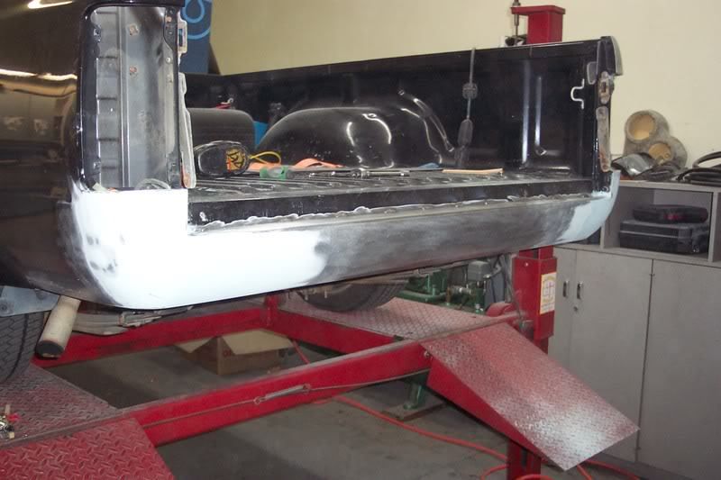

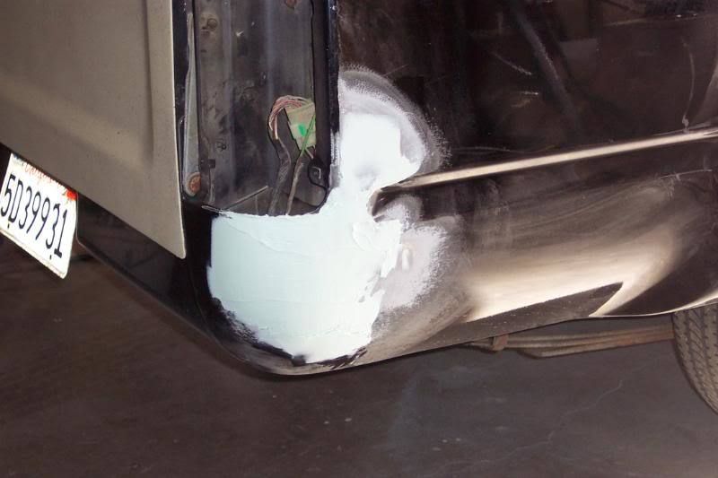

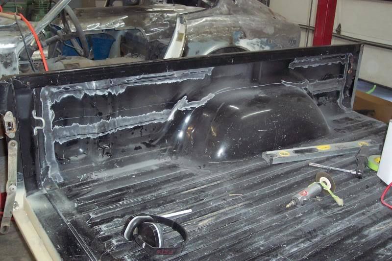

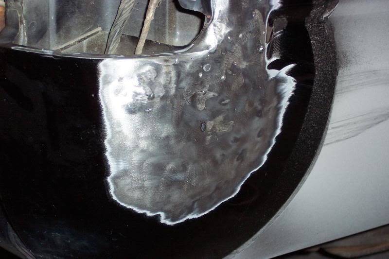

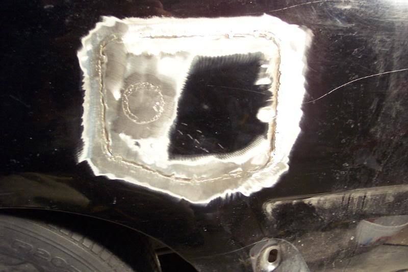

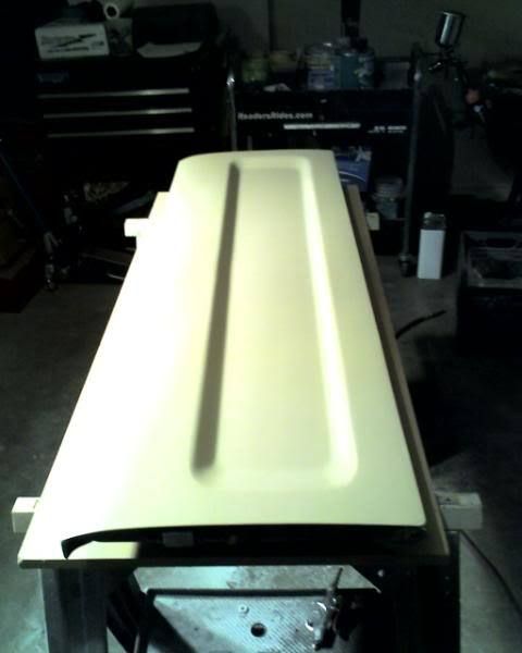

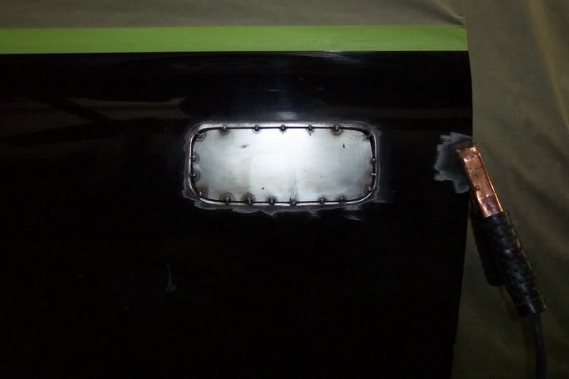

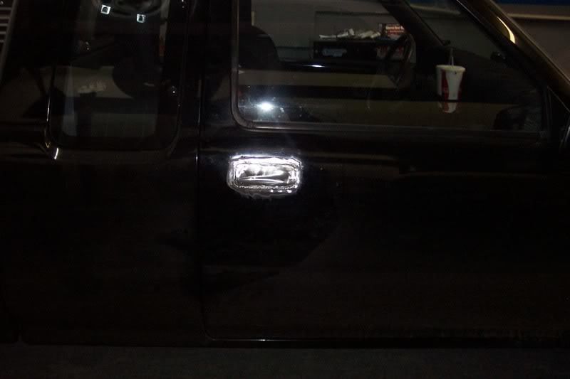

SHAVED THE HANDLE, WELDED UP A GRANT ROLL PAN FIXED ANOTHER DENT, YA KNOW SAME OL POOP DIFERENT DAY....OH YEA GOT MY OWN SHOP TO, BETER THAN WORKING OUTTA ,MY GARAGE, TO MUCH STUFF STORED IN THERE.....

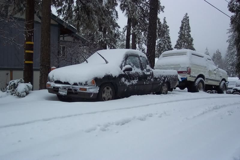

GOTTA LOVE THE SNOW........
OK THATS IT FOR TODAY I PROMISE.... LOL IM SHAVING MY HANDLES TONITE, HOPEFULLY IF FED-EX DECIDES TO DELIVER TODAY, SO ILL HAVE MORE PICS LATER....
LEMME KNOW WHAT YOU GUYS THINK....

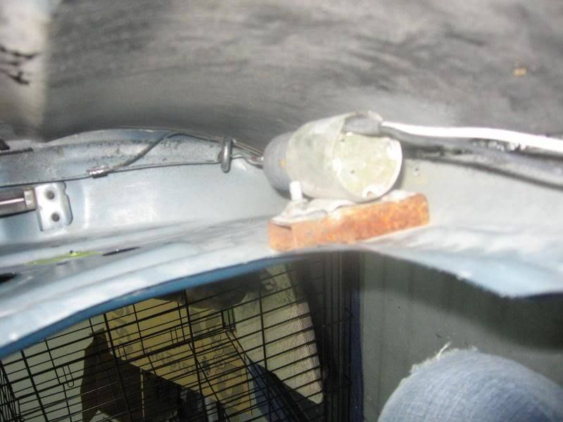

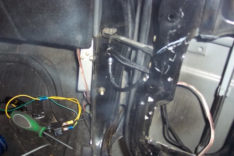

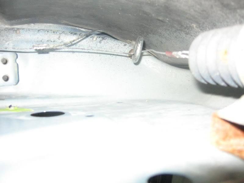

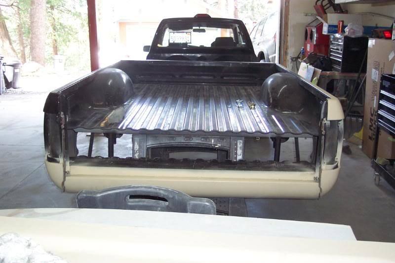

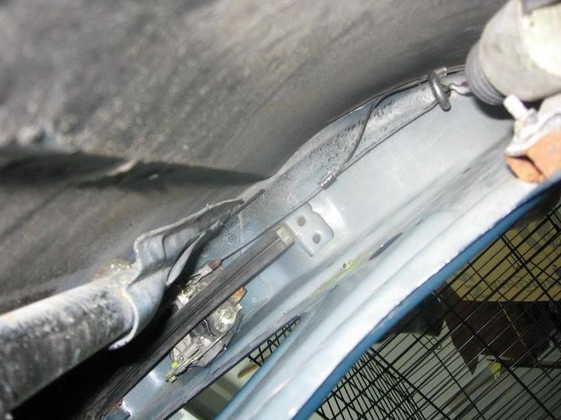

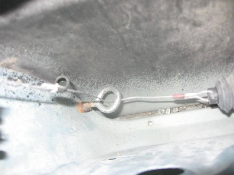

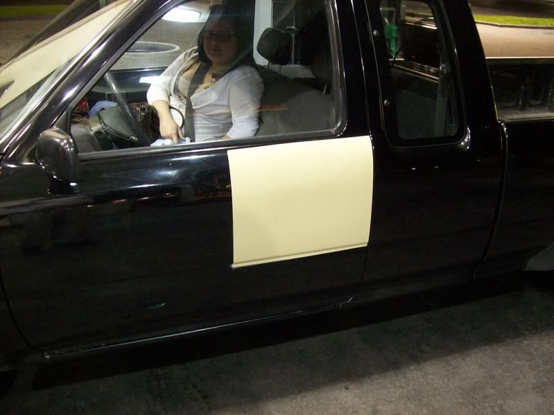

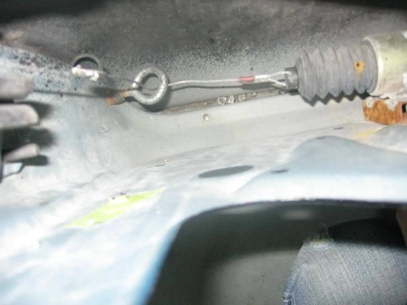

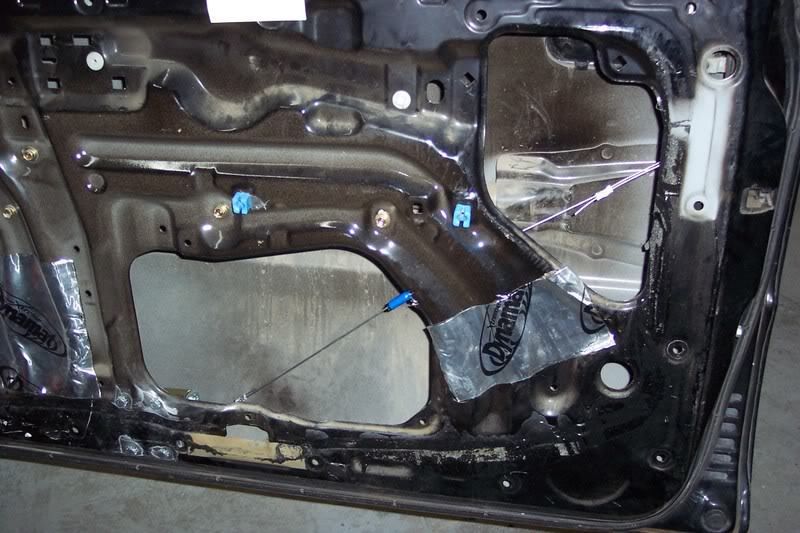

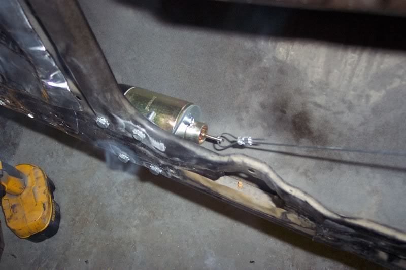

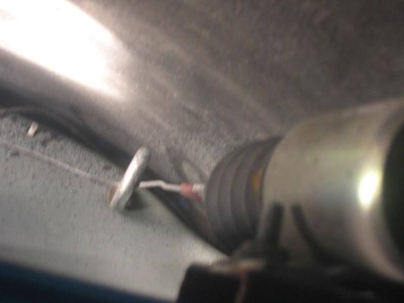

THANKS GUYS! SO I INSTALLED THE SHAVED DOOR KIT TONIGHT, WENT PRETTY MUCH WITOUT A HITCH, THE ONLY PROBLEM IS THAT THE SOLINOIDS ARE SELF GROUNDING TO THE BRACKET THAT IS SUPPLIED, WORKS GREAT IN THE DRIVERS DOOR, BUT THE PASS DOOR ISNT WORKING, I HAVE POWER GOING TO THE RELAY, AND OUT FROM THE RELAY WHEN THE BUTTON IS PUSHED, BUT THE SOLINOID ISNT POPPING!!!! HARMONIC BALANCER!!!!! I CHANGED OUT THE SOLINOID, THE RELAY AND THE "BRAIN" (RECIEVER) STILL DOING THE SAME THING, IS THERE A WAY TO GROUND THE SOLINOID?? ANY IDEAS WOULD BE MUCH APPREACTIED......
OH AND HERE IS A RENDERING, KINDA CHANGED A FEW THINGS AFTER SEEING IT, WAITING ON THE UPDATED VERSION....

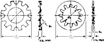

m_i_zombie
Use some of the external toothed washers on your mounting bolts. they help bite into the paint and make direct contact with metal.
