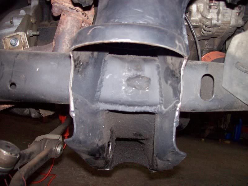

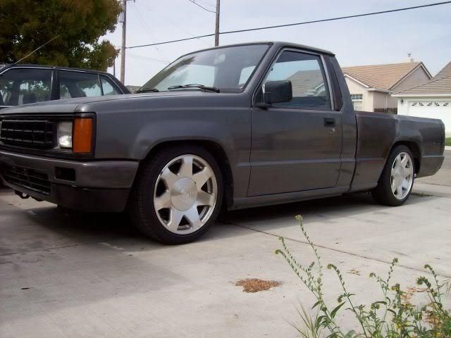

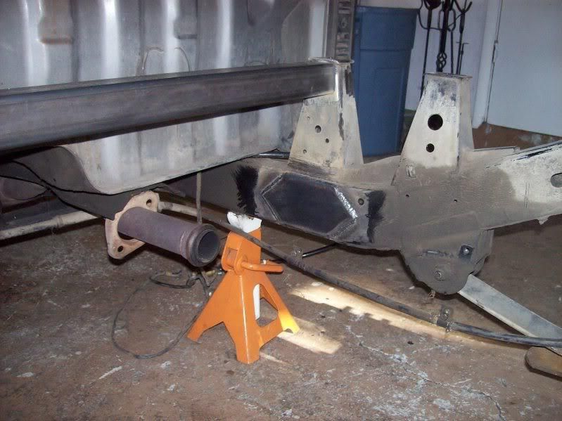

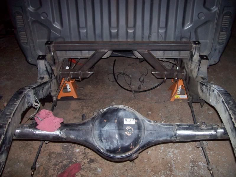

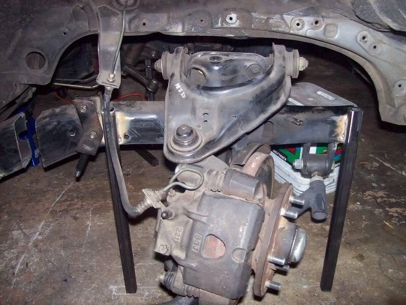

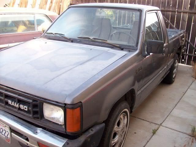

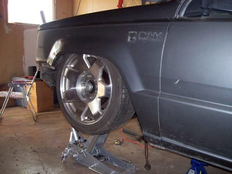

i started baggin the front of my 88 d50 then lost intrest for other project like my jeep but now i wana finish it so hopefully this will keep me going on it. i had a thread on mightyd50 but who knows what happened to that. well heres some pics.
the only stock pic i got

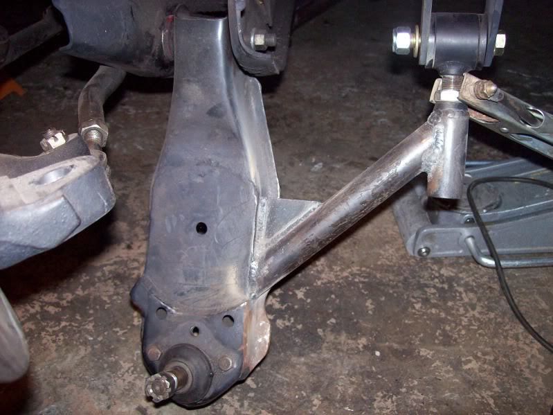

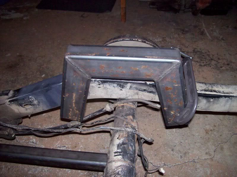

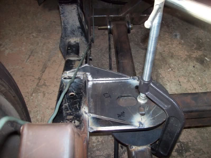

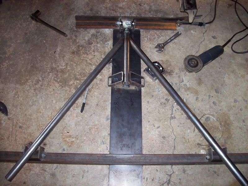

now the problem that stoped me from finishing the lowers have to be rebuilt so i can actually turn the wheel more i can only turn the wheel i full rotation of the steering wheel. im gona buy some more steel on monday and hopefully finish the front soon.

Looking good so far. What is it that your wheels are rubbing on when you turn?

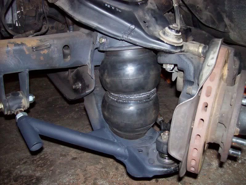

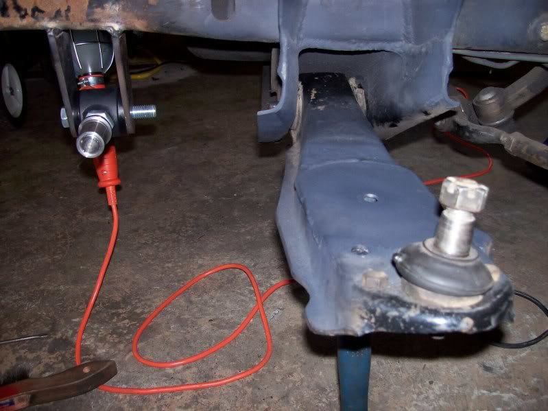

the wheels hit the lower control arms where i triangulated them. i got one side cut off just gota do some more grinding.
slow50
finally got both my lowers re done. now it turns lock to lock.

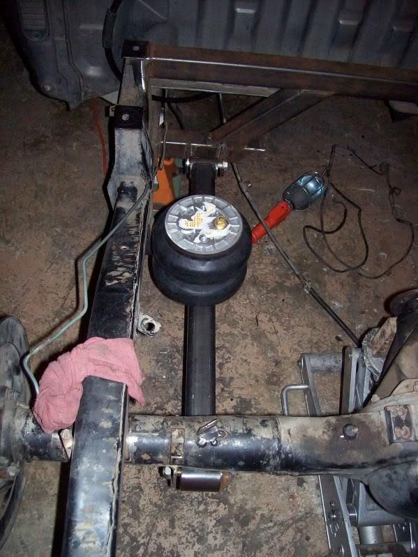

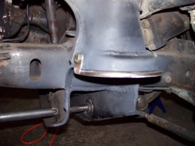

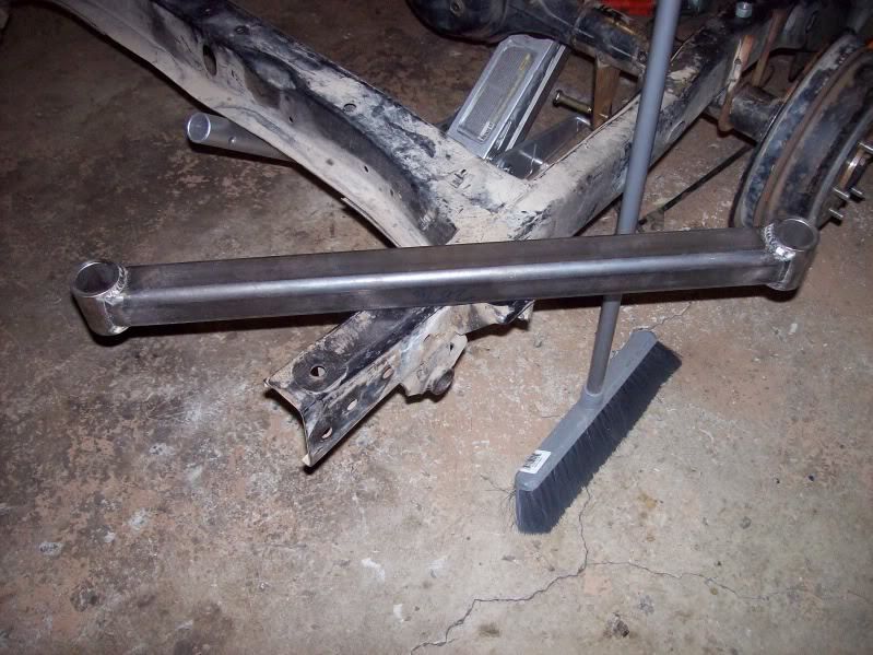

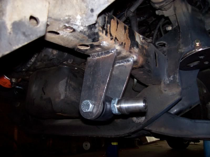

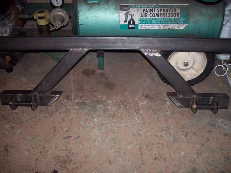

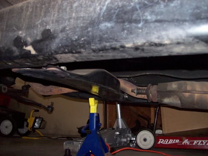

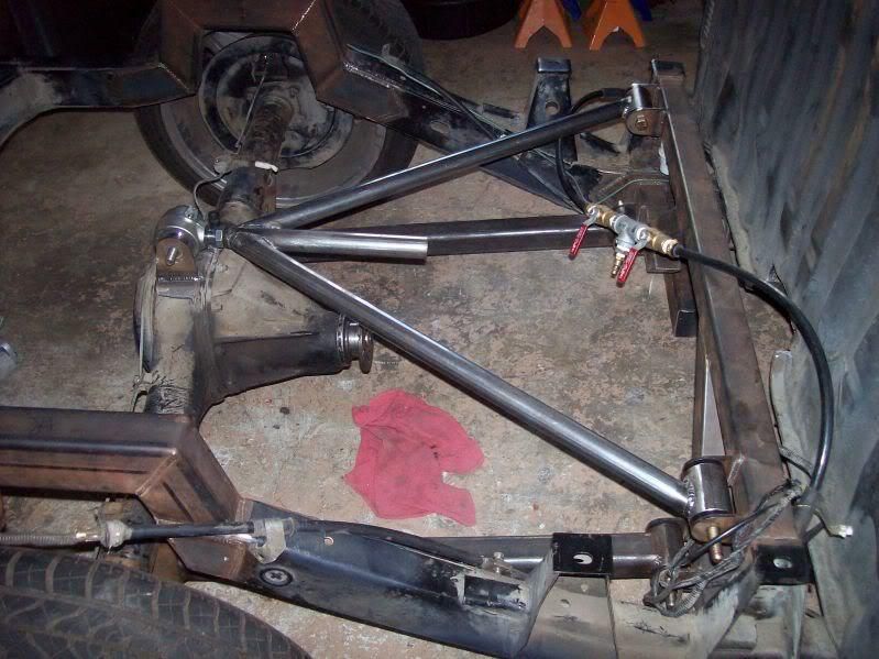

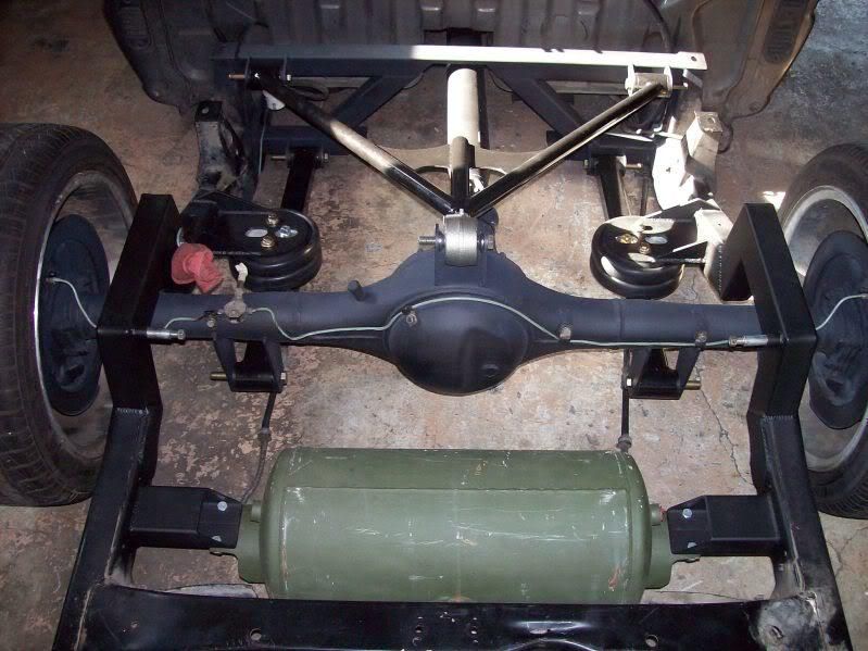

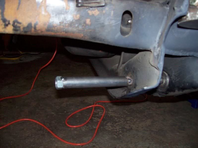

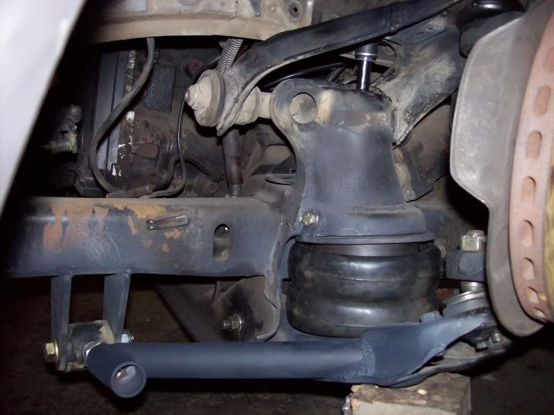

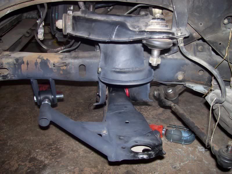

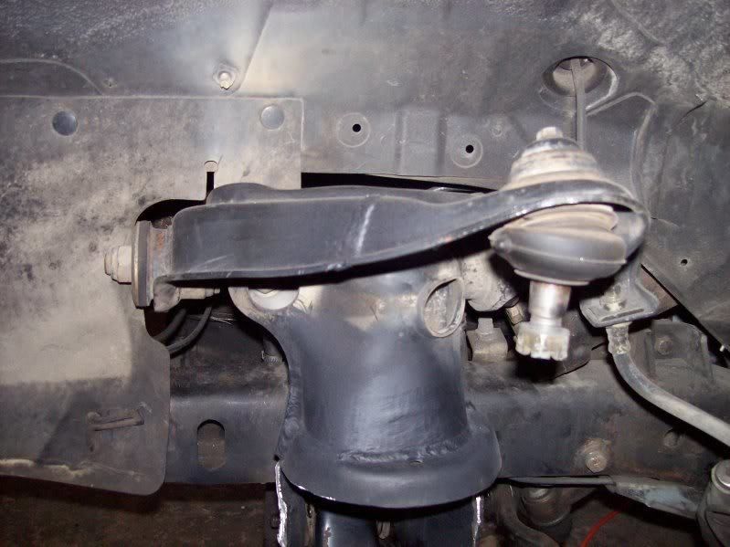

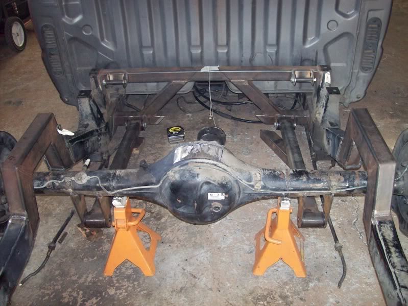

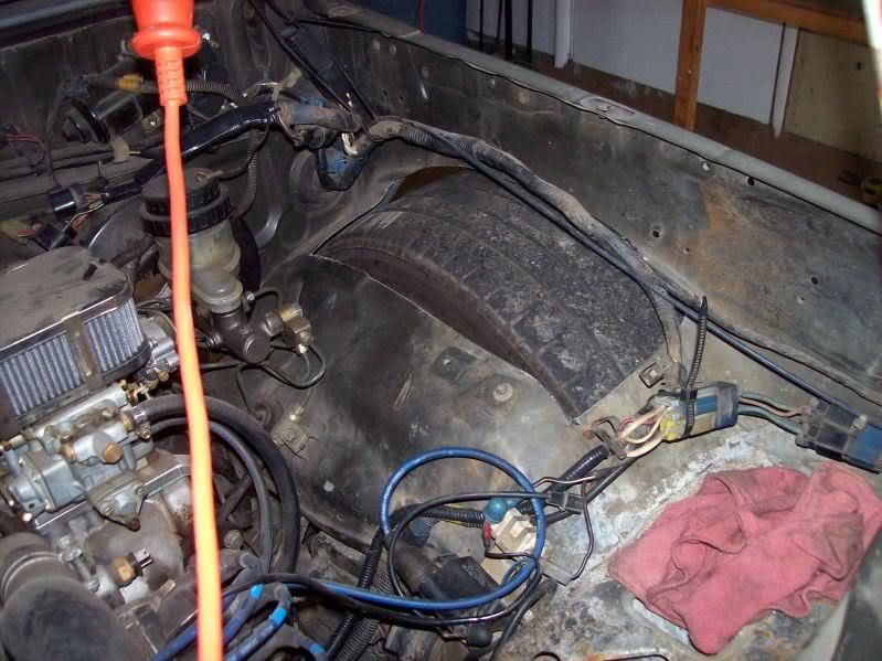

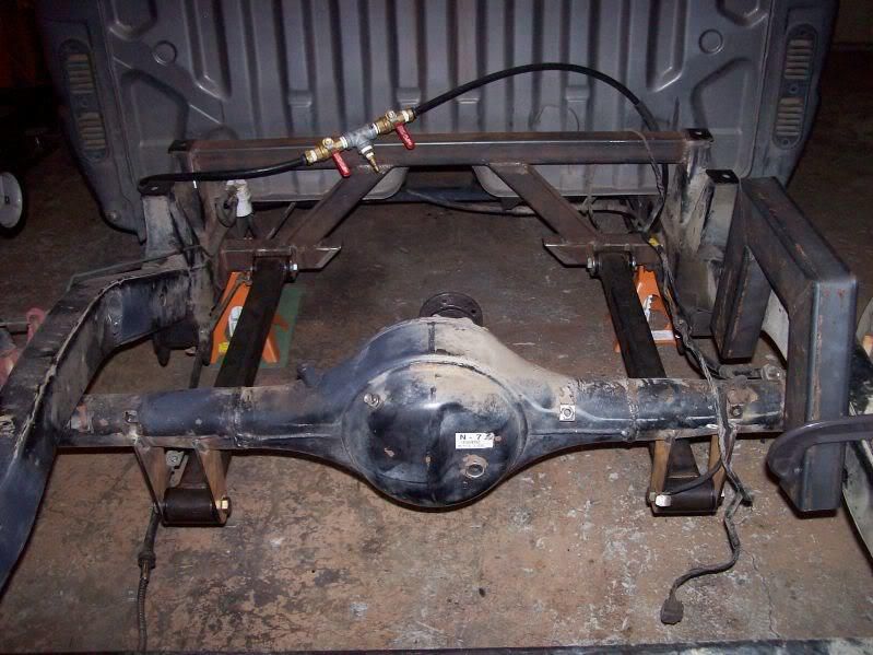

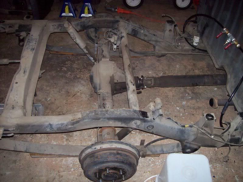

i got the front all done last week heres some pics.
and my super cool manual valves
