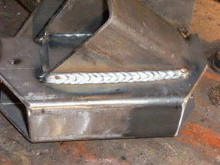

she isnt so much "auto" inclined as she is a minitrucker to the bone..... she welds better then me and im a union sheetmetal worker. so that means i have 15 years of welding exp and she has 1 year.. picked it up while i was building my s10. Every scrap piece i cut off for backhalf she would pick it up and weld it together and next thing you knew i was like.. wtf??
her first welds......
we bought the MM for her to do. She wanted a truck, i really dont have time for another and she said shell do it if i guide her. so were going at it starting tonight, static for the winter.

qballd50's avatar
qballd50
Man She Can weld!!!
Shes A Keeper!!
