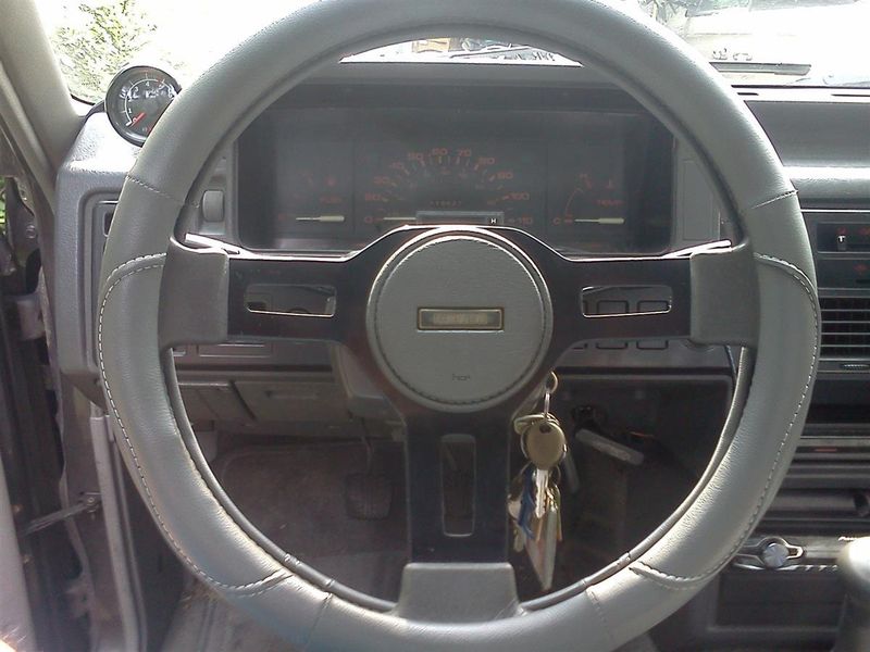

TL
the lizard king
I bought a Bosch 2.5" one from Advance. I have it to the left of the instrument cluster.
